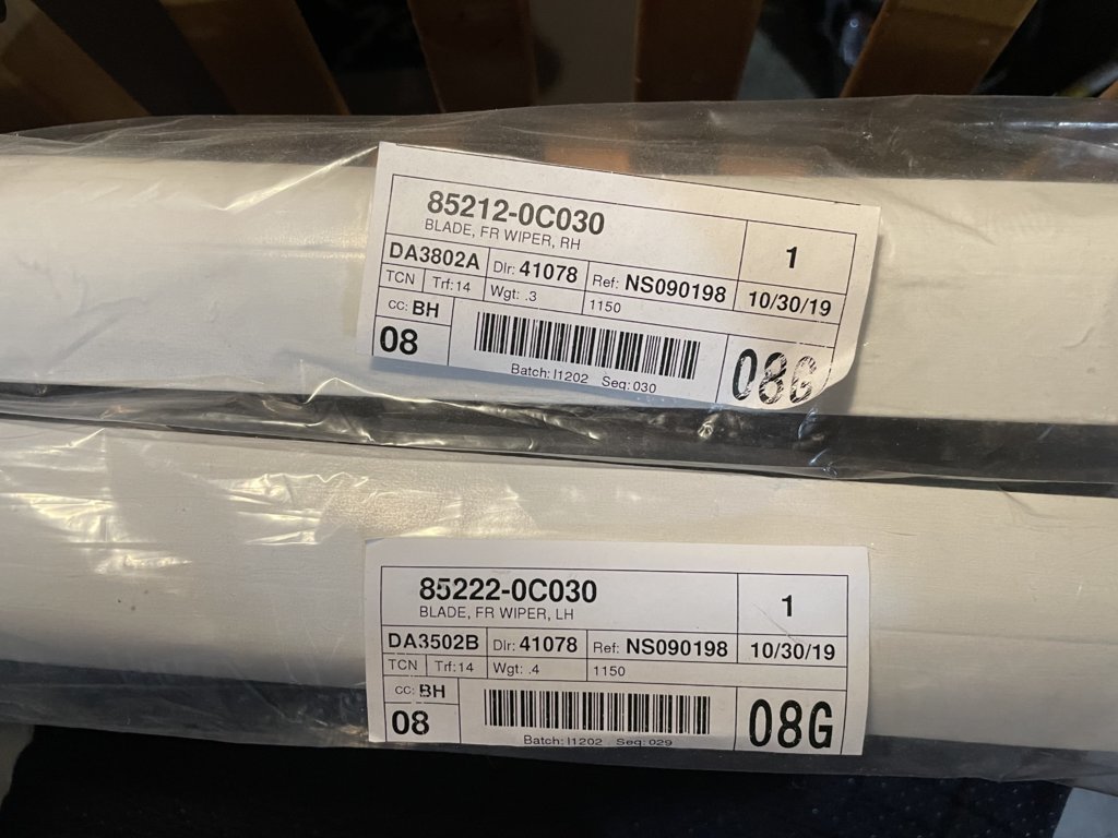

    Dealership. Don’t recall if they are sightline. But there are two oem versions. A cheaper set and a more expensive set. They’re usually about $50-60 each. But well worth it for how long they last virtually issue free.
    part #s
    85212-0C030
    85222-0C030

    You. Want. The. OEM. Originals (as the abbreviation implies).
    Here to help with a photo of the part #'s. Non descript factory packaging. And just to be crystal clear these are for gen. 2.5. I am also a testimonial that I get 4.5 years out of a set.
