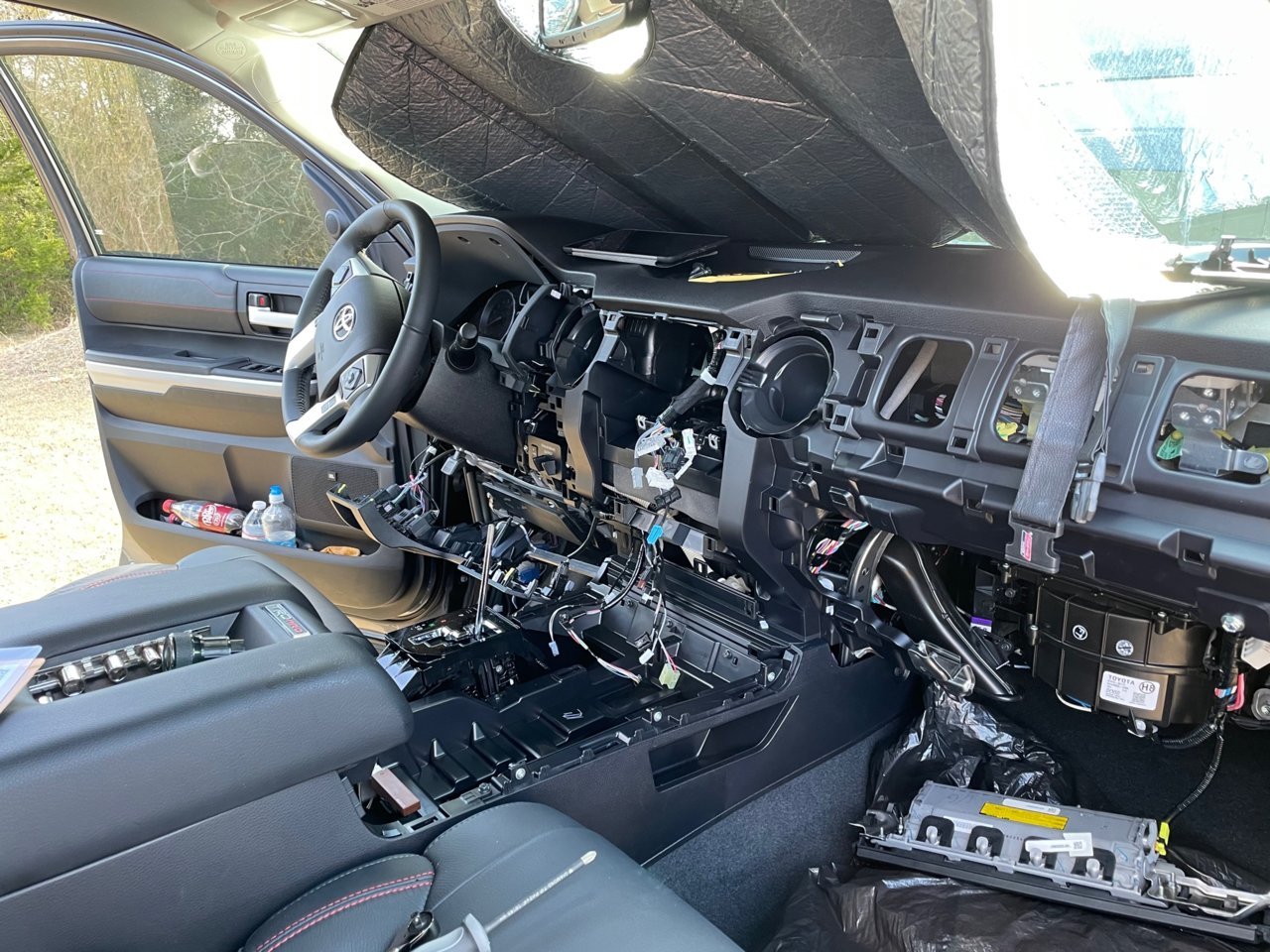

    There are some really good how to videos, but for those who just need to see a picture of "what is in there", I figured I would share.

    Cant wait to see finished product.

    You did all this to change out the radio trim?

    It actually looks way worse than it was. It goes back together way faster than it came apart. The only wrinkle was that my wife came out right after that picture was taken. The truck was 2 weeks old and she had no idea that I was doing that. It had a bit of a shock factor...

    Yes. I don't know what you call the gray piece that goes around the radio that has the vents in it. It snaps in underneath all of the other dash pieces.

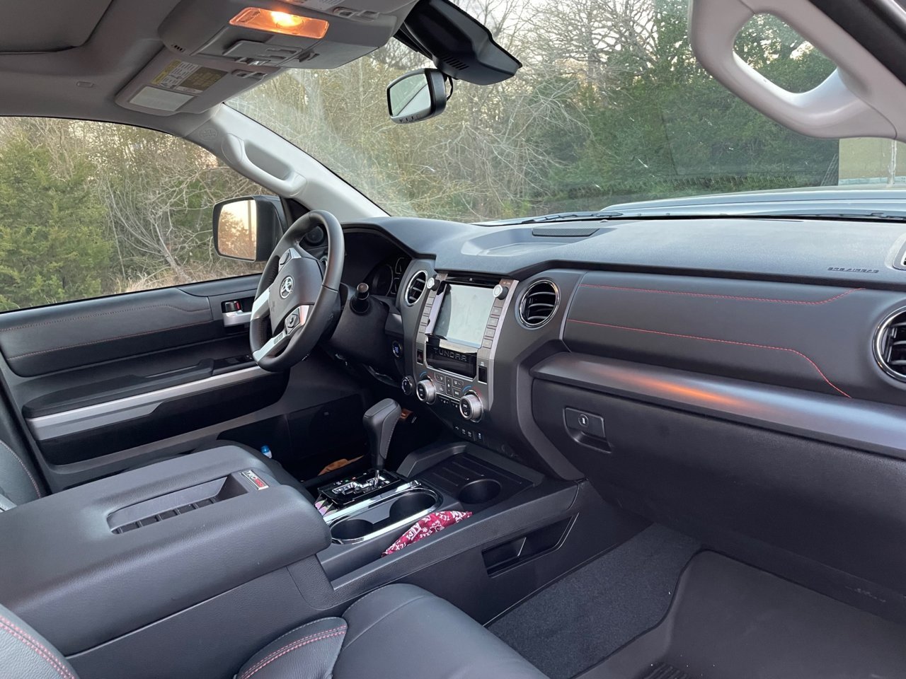

    Here was the result of this very first step:

    Wow! Drastically different look by changing 1 piece out. Well done :thumbsup:

    When i think radio trim i was thinking the silver stuff around radio.....where did you get these pieces...looks good.

    Got them from Sparks. Given the size of the piece and the fact you have to remove most of the dash to swap it, I went with OEM. I am going to paint/wrap other pieces that are easier to access.
