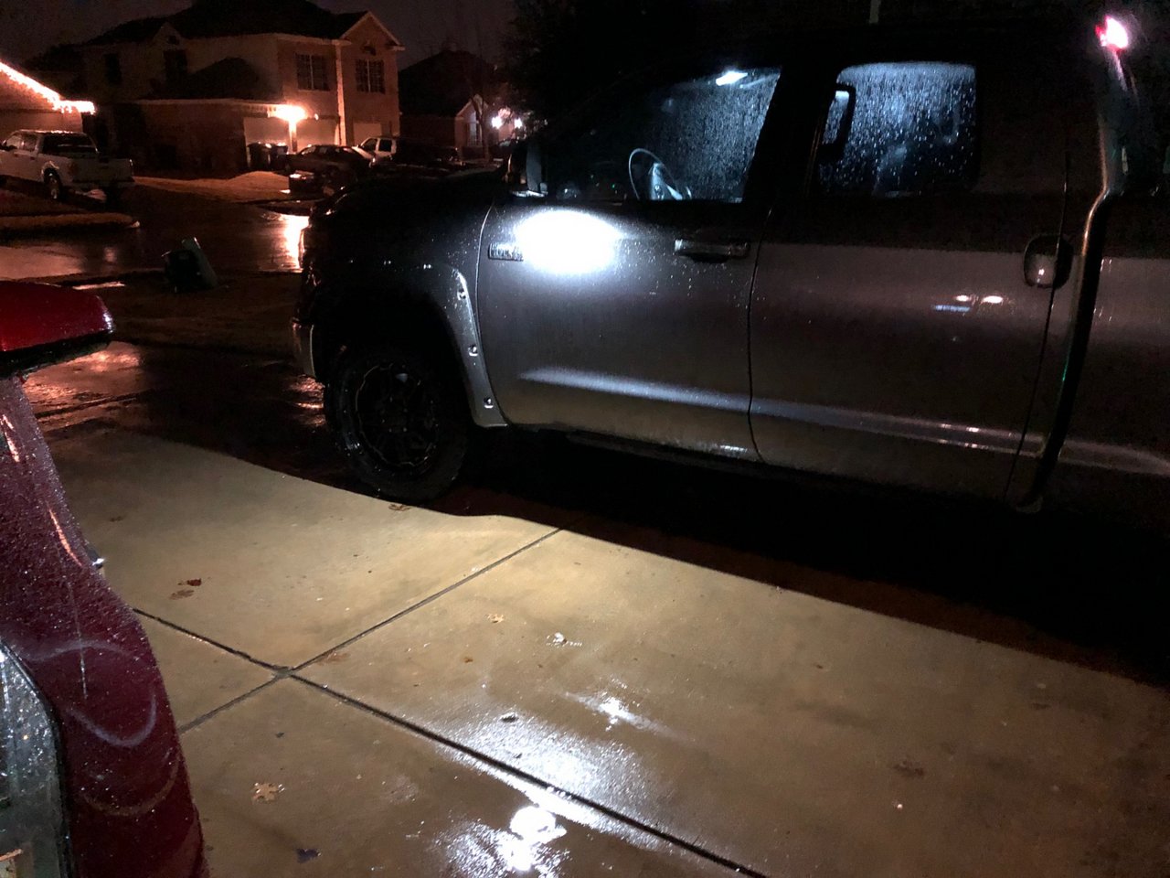

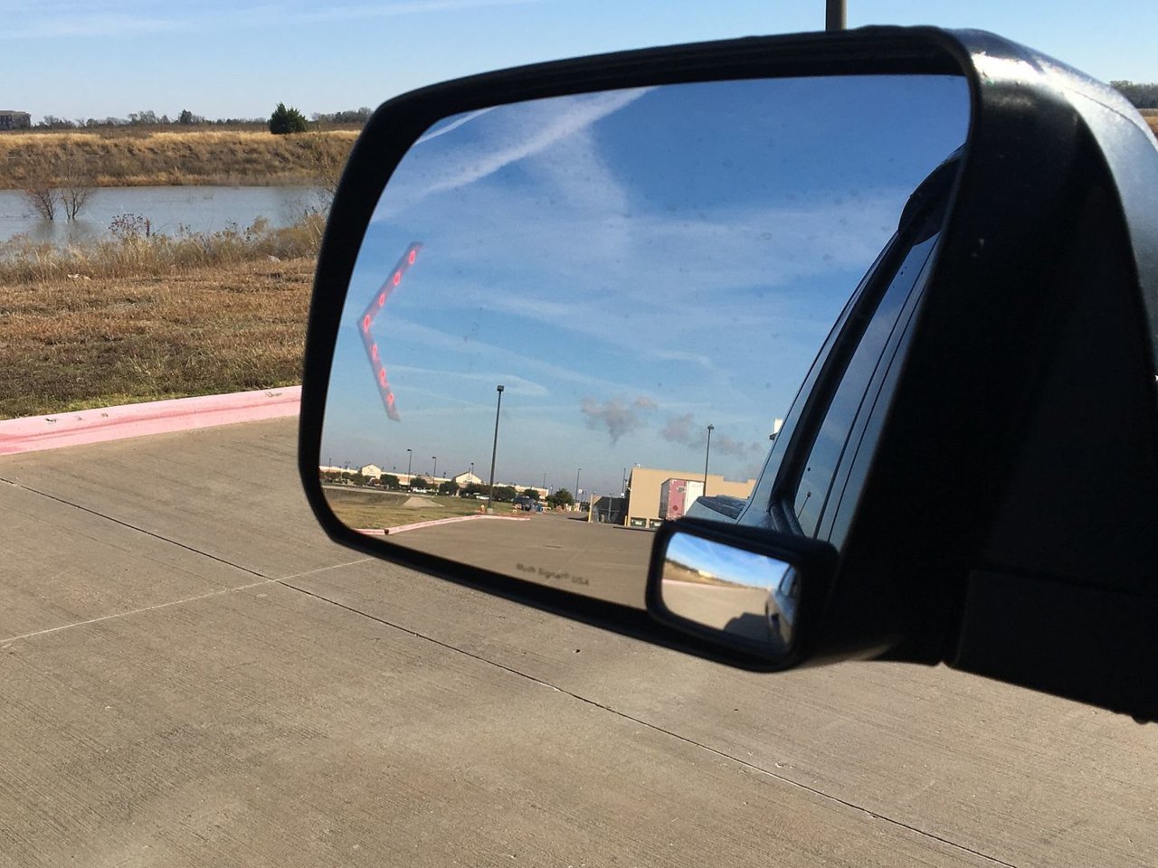

    1lowlife
    May 4, 2016
    #3296
    10,661
    DADA
    THE GREAT STATE OF TEXAS
    2014 MGM DC SR5
    I need them for a different reason, see below.
    I now have tiny little convex mirrors that work fine, but they are small.
    Big enough to see a vehicle next to me.
    God damn that pic is big...:eek2:
    26D8CB0C-A48A-4FE4-98CE-70212C595FB6_zps_d286208ec23a5bba0b14f7122486c9d4438a5e3c.jpg
    Oh, so it was you...:D
    No vibrations any more than the stock mirrors?
    I've pulled the mirrors twice over the years to tighten all the screws and bolts to stop them from shaking.
    I have red muth signal mirrors but when I get my truck back I have Hotshots tails to install.
    Then I will have an amber rear tail turn signal and there is no way I can have the mirror arrows red.:rolleyes:
    I like these better than buying amber Muths.

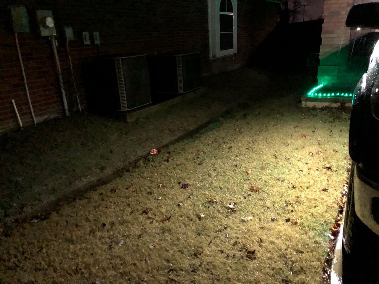

    Between the Muth mirror install and trying 3 different LEDs for puddle lights, I've had my mirrors out more times than I'd like to remember.
    If you're doing puddle lights, VLED is the way to go.
    I tapped into the little floorboard light (replaced that as well) so they dim on and off.
    UNIVERSAL LED PUDDLE LIGHT (vleds.com)
    3gnu04bz_zpsgecrr1ak_5ab0b9823af943a3dc90e6ae4019d9a6f86264fb.jpg f5xhgddq_zpsk85eh7wh_149b06814723553efce0701d6a9defe3bb03f7b0.jpg
