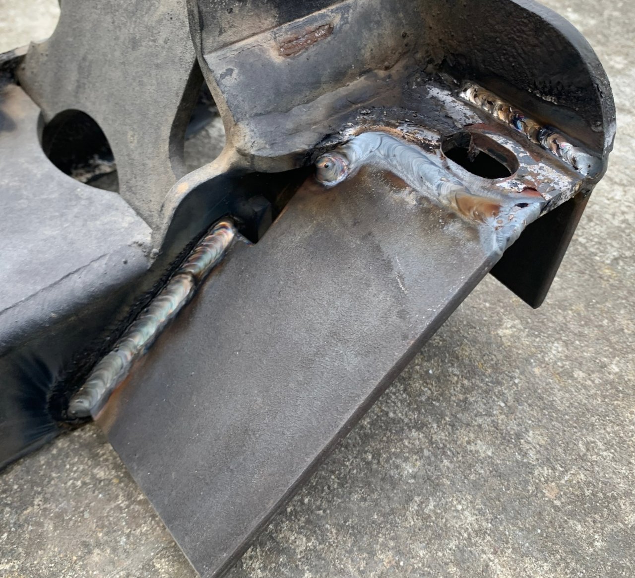

    Welded? What did you do?
  7. Mar 31, 2022 at 9:23 AM

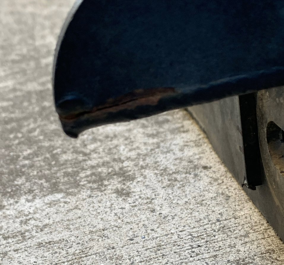

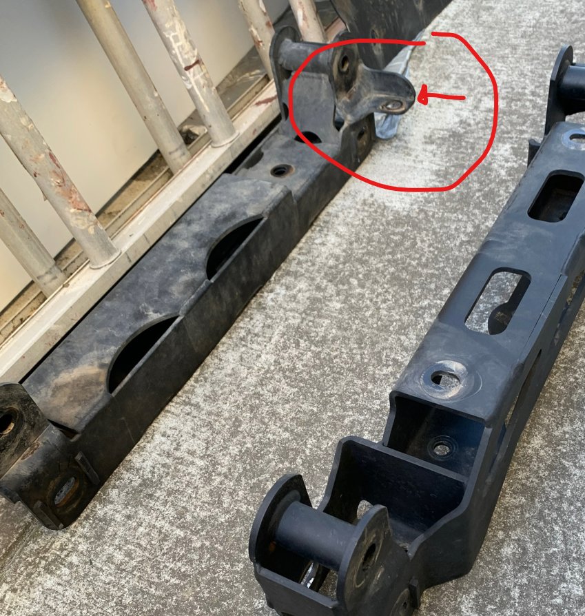

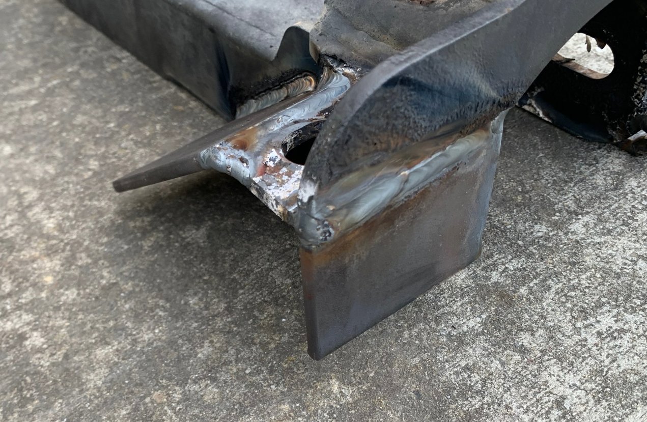

    There was a crack where the diff mount is bolted to the rear bracket. It was squeaking like a mofo.
    So I had 2 gussets added to provide more support.
