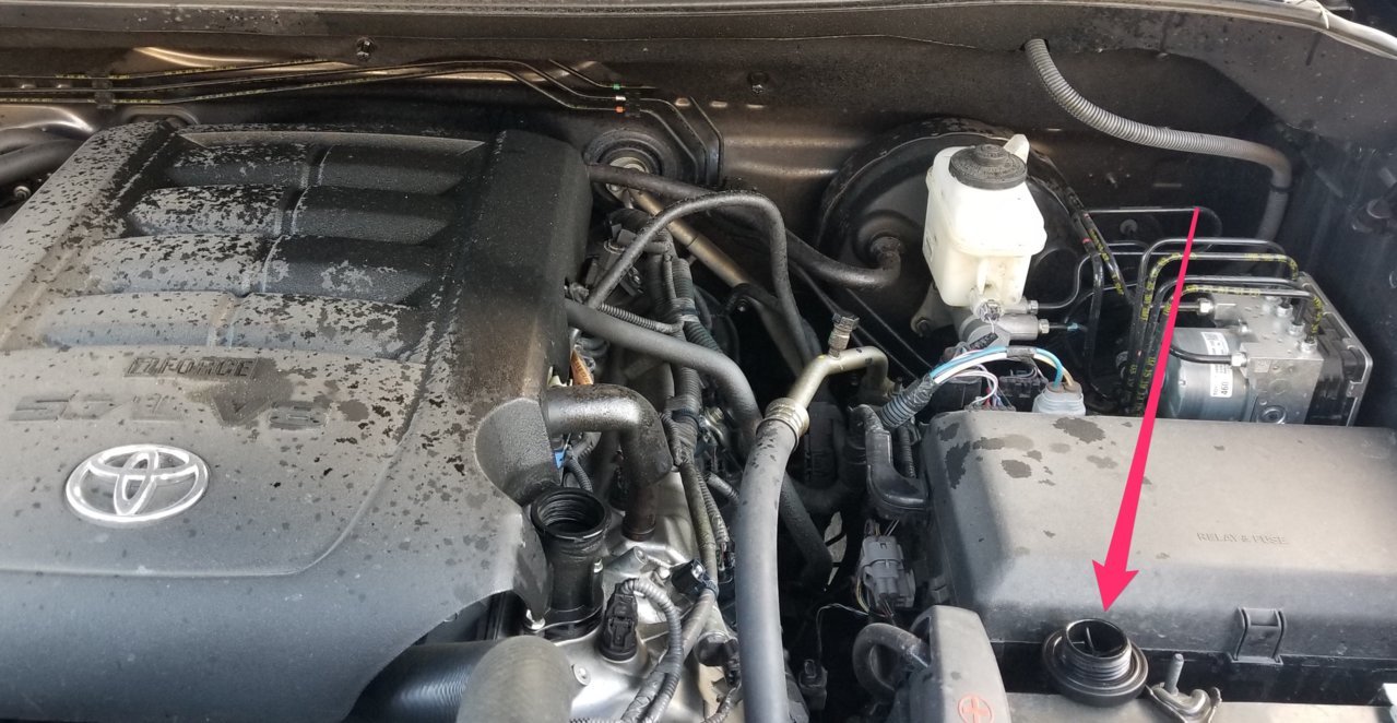

    So I popped open the hood today to refill the wiper fluid, and saw this:
    Two thousand miles ago, I had a Big O Tires do an oil change and rotate the tires. Not only did they rotate the tires in the wrong order I specified, but apparently they also didn't bother to put the cap back on the oil fill tube!
    Let this be a lesson -- change your own fluids. Doing this correctly is too important to trust to a shop, and it's really easy. I live in a condo complex and there are strict rules about not working on your car, but I'm going to have to find some way to bend them because this is lame.

    Good thing is they put your cap where it did not fall off! Plus, your engine bay is now preserved for life with a beautiful oil coat. Wonder how much oil you lost? What made you check under the hood?
  3. Mar 31, 2019 at 4:52 AM
    75,726
    Wow this could have turned out alot worse. How much oil did you lose?

    Yeah I was pretty pissed. The dip stick was still in the sweet spot so I don't think much oil got slung out, but god damn that could have been a whole lot worse. Just a few days back, my brother was telling me, "man I don't trust anybody to change the fluids" and then this happens. At this point, the only repair shop I trust to touch my Toyotas is a 5 hour drive away, in my old hometown, and at this point I've accepted my fate of never finding a trustworthy shop where I live now. Looks like I'm visting Mom each time I need a major truck service.
    I also have the "free" 10k oil changes offered by the dealership, but I would prefer just to pay out of pocket and do it myself, than to subject myself to the hustle at the dealership.
    I sent the Big O shop a polite email indicating the problem, along with that picture, telling them I would expect them to reimburse me for the cost of a new oil filter & change (elsewhere, obviously) because unknown contaminants may have entered through the opened fill tube; and, for the cost of a professional cleaning of the otherwise-pristine engine bay, to prevent the slung oil from compromising the hosing, paint, etc. We'll see how that goes.
    At the moment, I have the time and patience to take it to small claims court if need be, and I'm pissed enough that it would be something I would enjoy doing.

    The oil system is a pressurized system. Did your oil pressure gauge act unusual? I guess you would have mentioned it if it had. And I would have expected to see more oil mess if you had told me the story first and then shown me the picture second.

    1st sentence above picture. Adding windshield fluid.

    I see it now. The pic and red arrow grabbed my attention and then read the lower body.

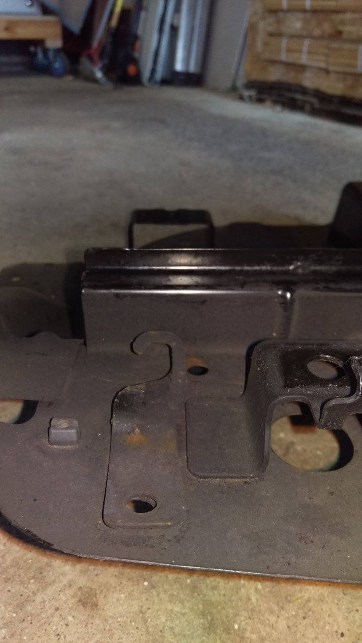

    Just so everyone knows who is not aware.....their is a skid plate MOD that makes removal/install much easier. It was talked about in another thread. Bending the hook piece over so it's flat will free up the skid plate to fall easily in place. Don't have any pictures but, will add one this weekend when I do my own oil change

    I'm going to give the shop owner a chance to own up to this before I make a big deal out of it and involve the corporate office and small claims court -- I, perhaps foolishly, like to think that there might still be people who have a sense of accountability. We'll see.
    Nope. I'm astonished that no sensors, lights, or annoying beeping sounds occurred as a result of the cap being left off. It seems I can't even look at the truck without some god damned sensor or beeping thing going off.

    Not the best picture but, you can see how the hook piece is bent over flat. This make a huge difference with removing or installing the skid plate.

    I find the hook helps me. Hook on the front, and get a bolt started in the rear.

    I could never get it hooked or the hook would get caught on something else which would then have me beating my head on the garage floor cursing like a sailor.
