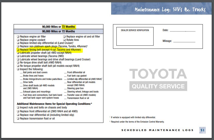

    Toyota says every 90K miles or 72 months for your truck...I bought my 1-owner 2006, 85K miles with meticulous records recently, but the timing belt/water pump had not been done...so it went over double the time and almost hit the mileage mark. I had it done shortly after buying it. Personally, if it doesn't hit the mileage and with current belt material quality, I'd go 8-10 years...but I wouldn't go 13 (like mine) or 19 (like yours) without changing it...no matter the mileage...the risk reward on a nearly perfect Tundra like yours is just not worth trying to eek out a few more bucks by delaying it. I'm also curious what you paid for something like that such low mileage?
    https://www.toyota.com/t3Portal/document/omms-s/SMG100_MS0001/pdf/2000_Toyota_SMG_PDF.pdf

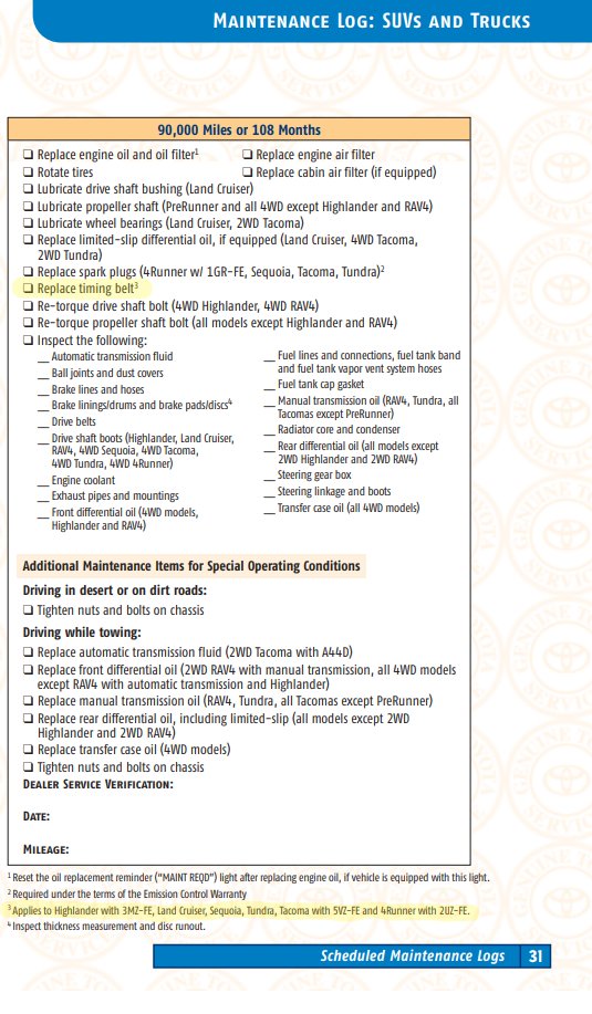

  20. May 7, 2019 at 7:56 AM
    Festerw
    Festerw New Member
    May 7, 2017
    #7600
    3,880
    Cambridge Springs, PA
    04 Tundra DC
    Interesting I wonder why they changed the schedule. This is for 04.
  21. May 7, 2019 at 8:26 AM
    speedtre
    speedtre New Member
    Jan 20, 2019
    #24808
    1,699
    Inland Northwest
    2006 BSM Toyota Tundra DC TRD 4x4
    My best guess would be improvements in belt material quality l.... I pretty sure Toyota changed the timing belt interval in early 3.4 V6s from 60K (96-97) miles to 90K miles on later iterations (98' -2002') and it was the same exact engine...for the same reason I suppose.
