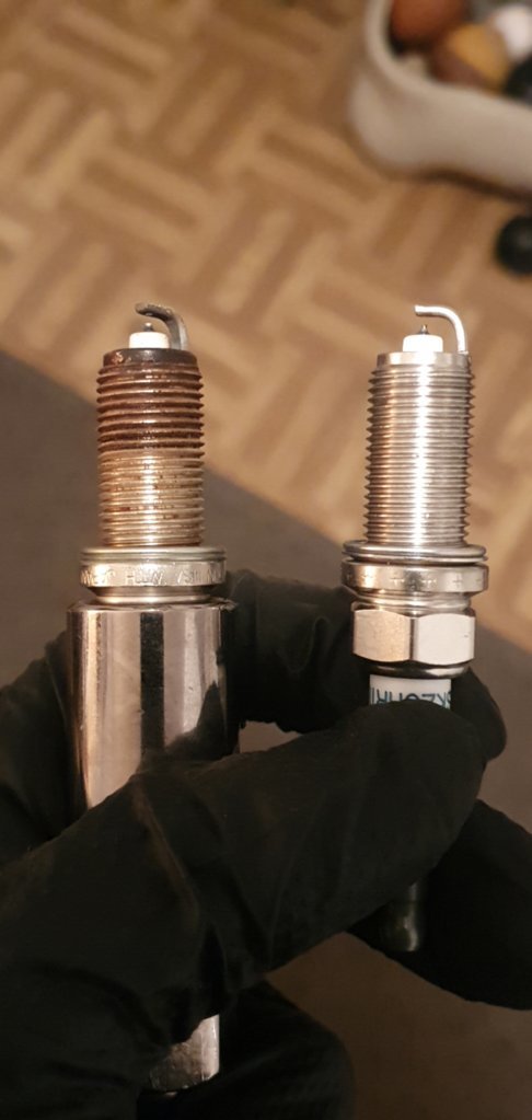

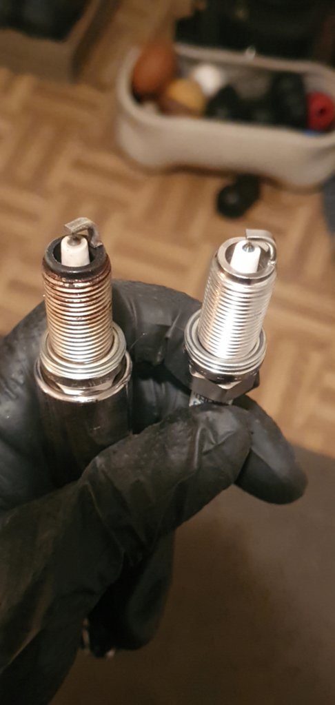

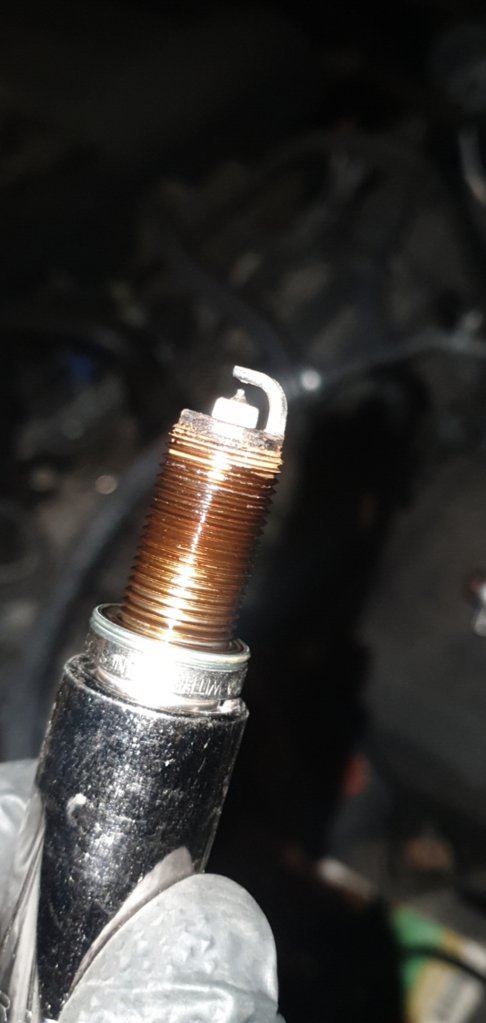

    I didnt want to wait til 120k to change my plugs so I did them today at 60k. My reason for changing them wasn't due to thinking the plugs wouldn't last til 120k, its that they could be hard to get out at 120k. The threads on mine had already started to get some corrosion on them so I'm glad I did. The job wasnt too bad. the driver side plugs are pretty easy to access. The passenger side I just removed the top of the airbox and the intake tube going to the engine. A couple extensions and a ujoint socket adapter can get the job done. I found it easier to not use a spark plug socket to put the plugs back in simply because my plug socket sticks so good that the extension pulls right out of it when the plug is being held in. I used OEM plugs part number 90919-01191 they are Denso SK20HR11. Be sure when buying plugs to buy them from a dealer, online or in person, not from eBay or Amazon, there are a lot of counterfeit plugs out there.

    I’m surprised they look that good after 60k honestly. Either way, good job.

    Use anti-seize or no?

    I've always gone by the plug manufacturer suggestion of no anti-seize and the plugs from factory didnt have anti-seize on them. That said I kind of wish I did put a little on them after seeing the crud on the threads.

    I'll use antisieze to reinstall old plugs. Very top of the threads where moisture can reach. Extra confidence since aluminum heads require less patriarchy, and you just give up early.
    also, i use kopperkote & a dap on the top bulb of the sparkplug aint never hurt nothing if your frugal.

    It's not corrosion, it's cooked oil.
    Old plugs look like they can do another 60k miles easily.

    I had a very bad corrosion that lead to no threads in just two winters. That's how I learned.
