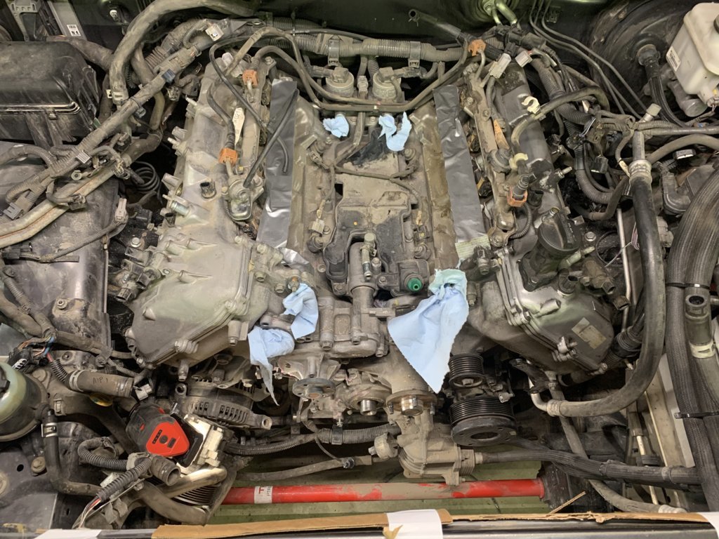

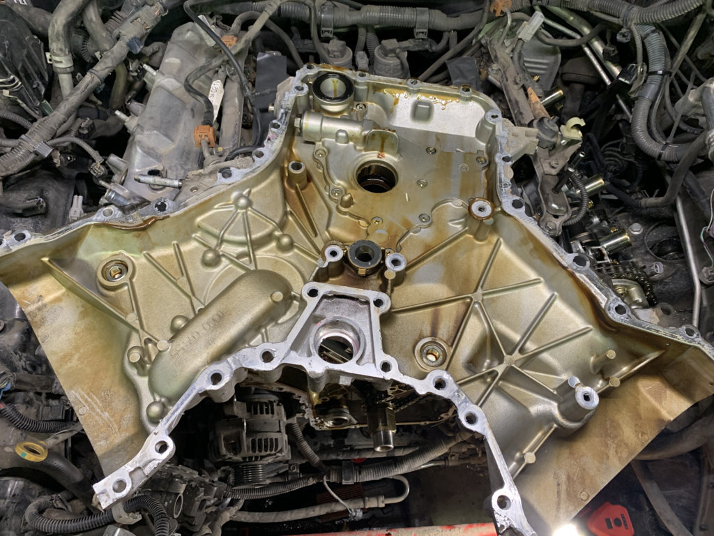

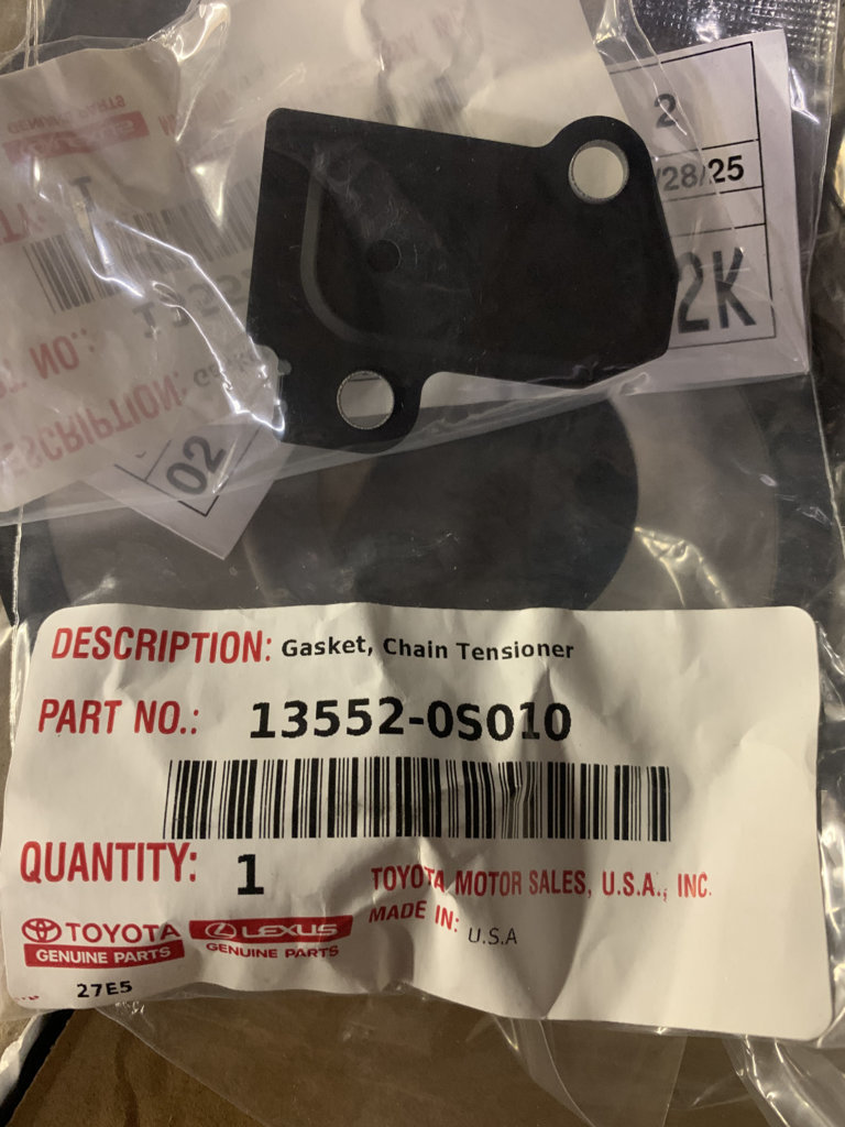

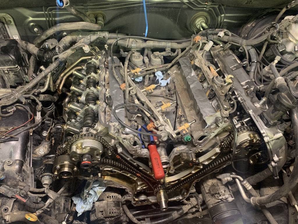

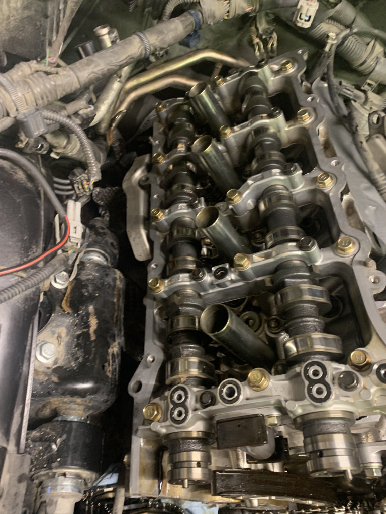

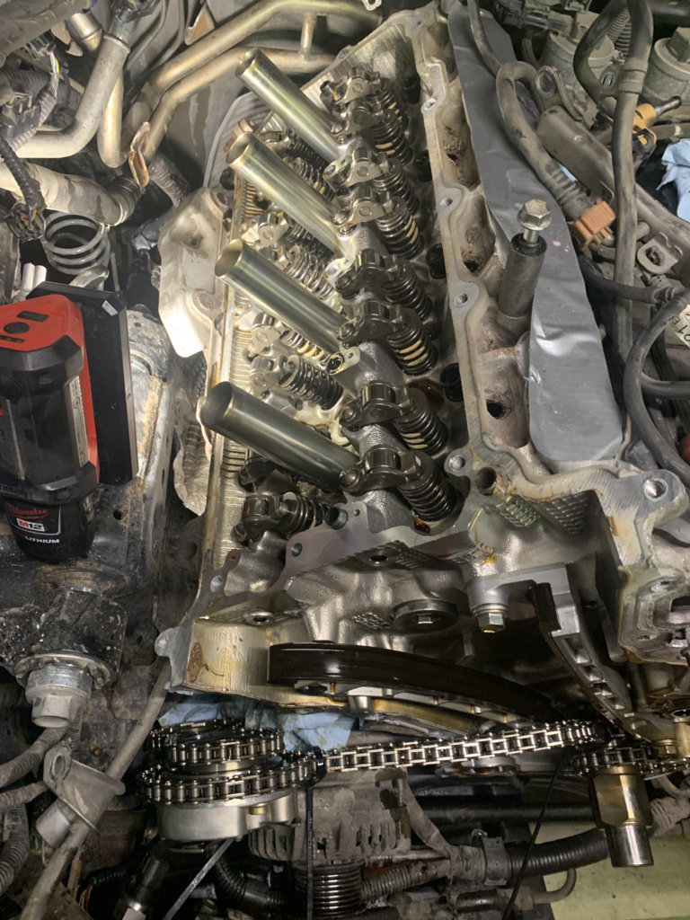

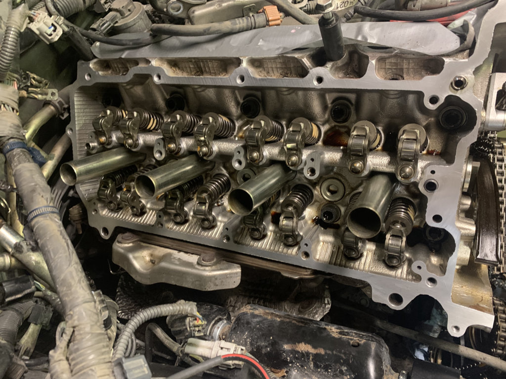

    So I JUST finished this job on my 2013 4.6L (essentially the same as 5.7L). It was a bitch but I'm really glad I did it. Sometimes after I finish a job like this, I like to research what the dealerships/shops are charging just to justify my effort and that's how I found this thread.
    Just yesterday I took her out for first long test drive and everything is running fantastic. For the record, I'm a self-taught DIY guy so this job might be easier/faster for someone with experience. I was also working in 20 deg F winter conditions for a lot of this, which doesn't help either.
    Although there were parts of the job where I definitely questioned my decision to take this on, I think the part that pissed me off the most was the lack of information from Toyota on the part numbers for gaskets/seals, so hopefully I can help out there. Half the gaskets in my Felpro valve cover gasket kit were wrong and Toyota was not much help in identifying what was needed. The local dealership parts guy tried to help, but at the end of the day it was forums like this that saved me. Why doesn't Toyota have a pre-assembled kit with part numbers for all the gaskets needed for valve covers, timing covers, etc?!
    I used the YouTube videos referenced above, the best being Dan's Small Engine and the last video of the Russian guy changing the timing chain. But both of those guys skip steps, and I had to find other resources to fill-in-the-blanks. The cam tower reseal video was also helpful but could have been a lot better if he slowed down and explained a few things instead of playing horrible music over the video.
    I also recommend a 2-part video from Timmy the Toolman, but he only does valve cover gaskets: https://www.youtube.com/watch?v=ASOIvxWogWI&t=2476s
    I did not film my work but I did take some pictures along the way that may be helpful. I'll post them on here somewhere (where ever the appropriate place is) and I'll let you know...
