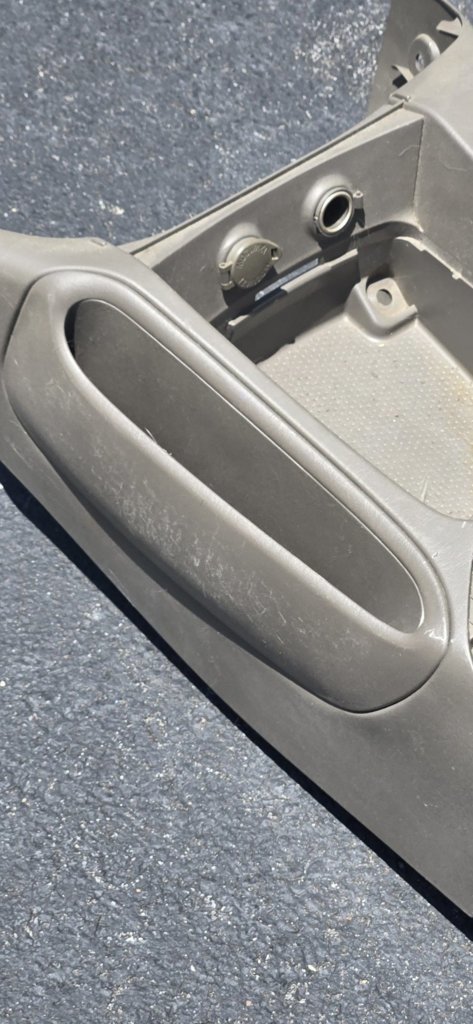

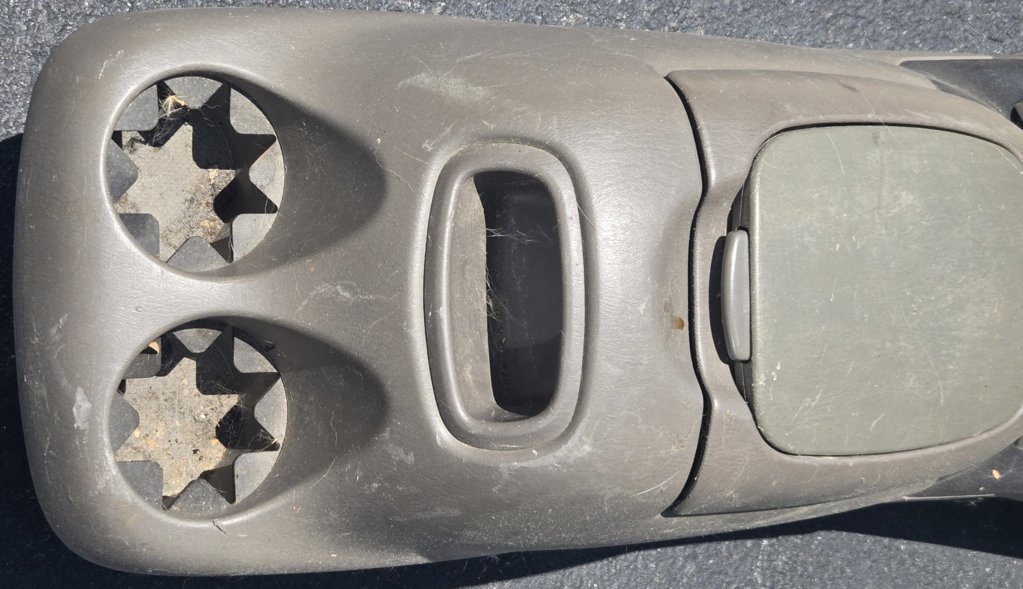

    So I found one at a used parts yard. It's in "ok" condition but would like to minimize the scuffs and scratches. Problem is I am not sure if that is possible with the material, presumably plastic. Maybe painting would help by coloring the scuffs?
    So thought I'd ask the forum to see if anyone has suggestions on making it look nicer. Would also be interested to know if anyone has swapped out the more spartan center console for the nicer (in my opinion) version. Curious about connecting the electrical components.

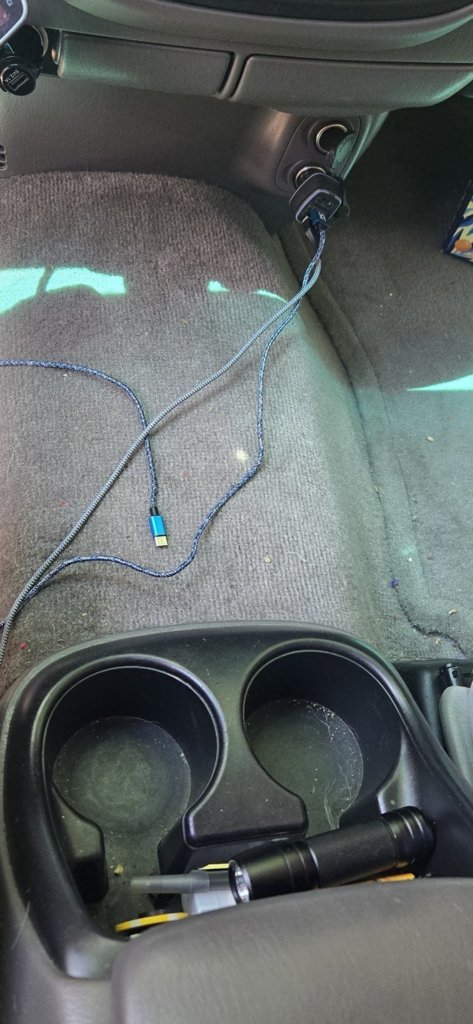

    My current setup

    A heat gun will do a lot to restore the color and should remove some of the smaller scratches once you do a thorough cleaning on the console. Look it up if you haven't done this before, there is room for error...
