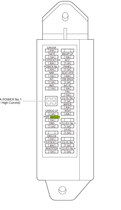

    Did you check the fuses?
    I think it has it's own inline fuse.
    Do your power outlets work?
    The charger is tapped into the power outlet circuit.
    In my 2014 the PWR OUTLET fuse is in the underdash fuse box.
