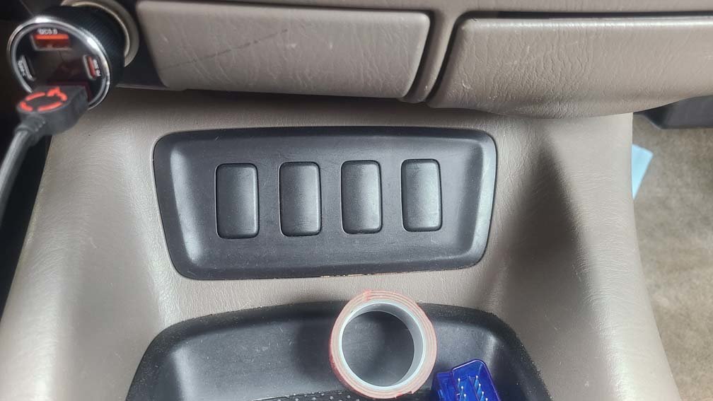

    Gents,
    I don't want to break anything if I can help it. Can this panel be moved without removing the whole console?
    Or... can those empty switch covers be removed from the front? I haven't tried prying on off yet.
    I need to find a place for my REDARC brake controller adjuster knob.
    Thanks,

    Yes, use a pry tool and remove the black pc the tape is sitting on. You can probably do it just by using your hands. Once that’s up put you hand in there and use your fingers should be able to pop/push it out.

    Be semi cautious if you take the 4 button piece out when you are putting back in. On back side at bottom are 2 tits, lack of better description, that fit in hole slots....make sure they line up.
