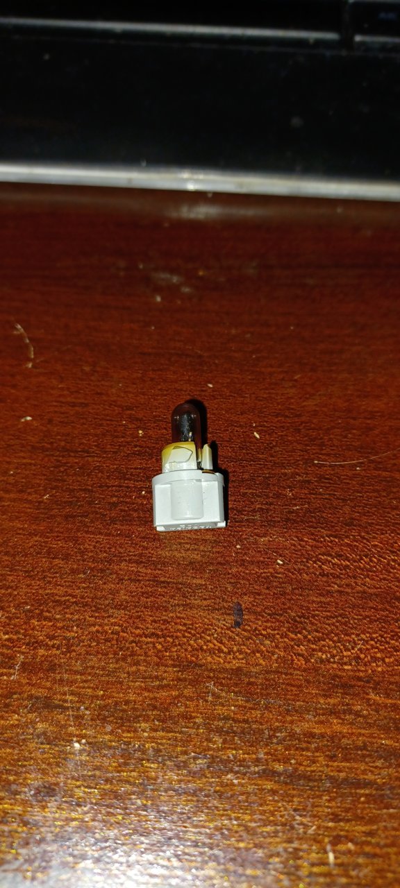

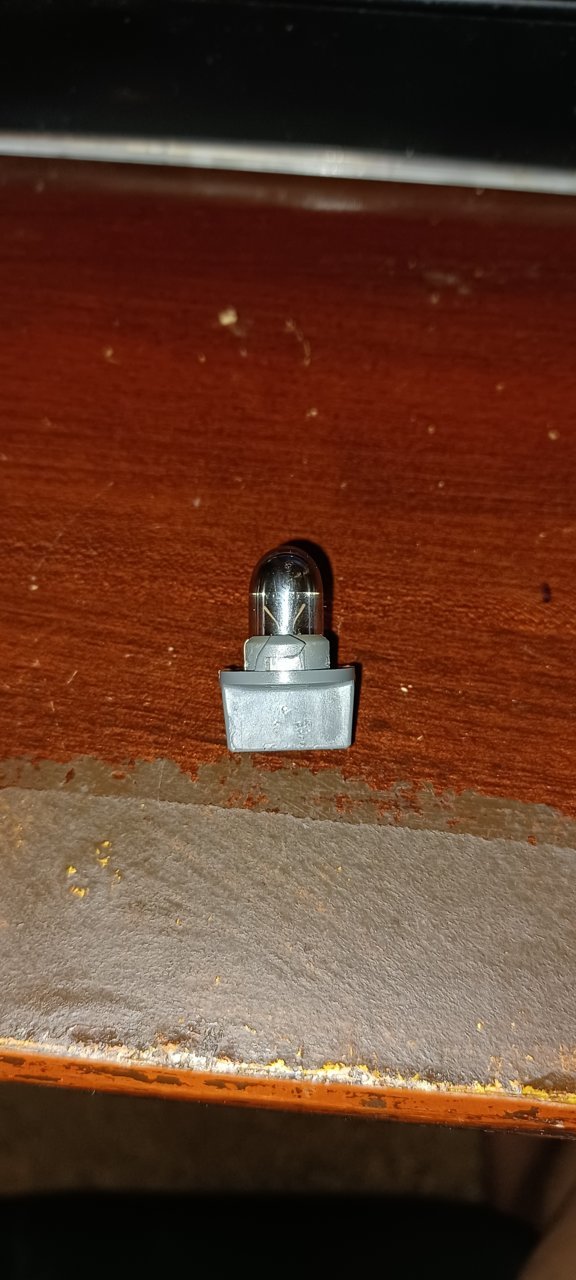

    Okay, folks, I watched some YouTube videos and found out how to remove the center console to check what is going on with the lights. I found out that two bulbs were burnt out, one big one, and one small one. I think these are called wedge bulbs or something like that. I have attached the two photos, but because they are burnt out I cannot read and part numbers or anything. I also took off the green coating to try and find some kind of info, but there is nothing. I managed to save the green coating on the large bulb, but the small one is crumbled all to pieces. So, now I need help from you folks to try and determine where to find the replacements for these to include the green coating or some other option, thanks in advance, salute20210812_180829.jpg 20210812_180858.jpg 20210812_180858.jpg 20210812_180829.jpg 20210812_180858.jpg

    Can I get the LED equivalents at a parts store?

    You can just gets a little expensive, They sell a kits so you can switch everything to led for about 12$. Might just want to switch them all out at once

    Okay, I will change all the centerconsole to LED.What about the other instrument panel lights, should I change those over as well, if so, are they hard to remove and re-install?

    I did all my lights, and it was all just plastic clips. The gauges are the only thing you can’t do on a 06 (based on other threads).
    I used this for the doors, cargo light and some dash
    SEALIGHT 194 LED Bulbs 6000K...
    and this for the rest of the car.
    LEDpartsNow Interior LED Lights...
    I’m sure there are better kits online.

    Make sure that the bulbs will come out of those sockets before just buying new bulbs or LED. Sometimes they won't come out and you may need new sockets. Good quality LEDs and sockets on Superbrightleds.com

    This is an update, thanks to all the excellent advice this issue is resolved. I have changed out all bulbs to green LRDS, I can see all the center controls now, thanks everyone, salute!
