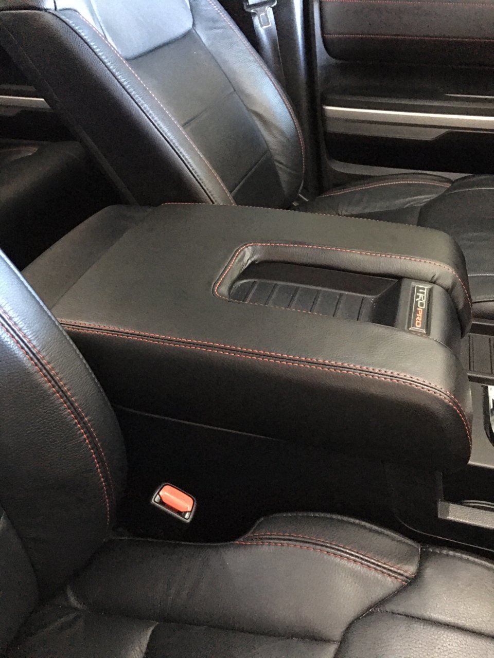

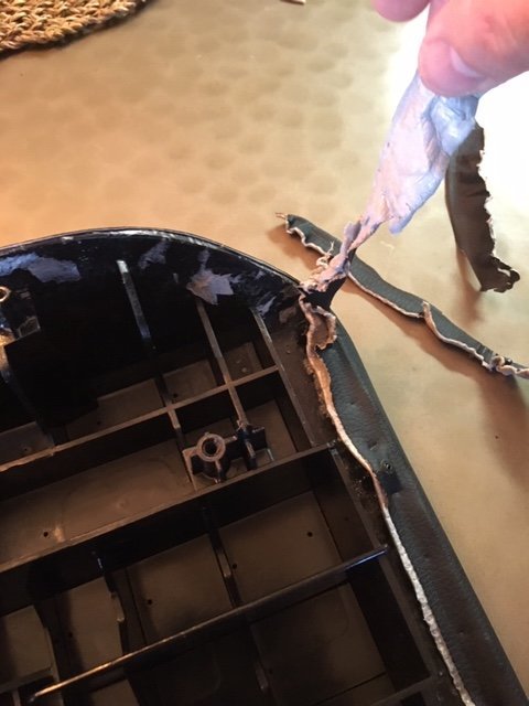

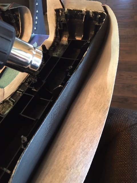

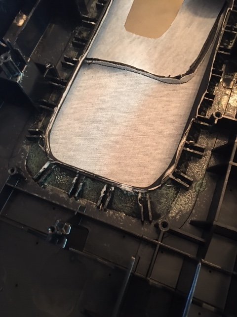

    Should be able to take it apart and re glue it. Here are a few pics from me adding leather to mine

    Contact cement. Flammable so use it in a ventilated area and be careful with the heat gun.
    I applied it where it was needed then hit it with the heat before laying in the leather. I have some more pics. PM me if you want them
