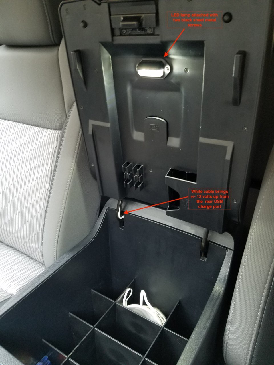

    I recently installed this switch actuated automatic light on my 2018 Tundra SR5 DC. Here are some nighttime pic's:

    I had previously replaced the cigarette lighter jack (hence no pic's) on the rear of the center console with the dual USB charger unit. This charger has 1/4" spade terminals. I cut off the original cigarette lighter jack plastic connector and crimped on the piggy-back terminals to the original wires. So the console light gets its power from these piggyback terminals. You route the +/- 12 volts up the hinge channel. I used some nice white flexible jacketed cable I had, should have colored it black (Some power adapter wire would be ideal).
    The wiring:
    You simply wire it up so the red +12 volts is interrupted by the plunger switch.
    Overall this setup is almost perfect.
    One negative is that because the power is from the cigarette lighter circuit, the light is only operational when the ignition key is turned on. So if you need to run out at night to grab something quick from the console, you need your keys or a flashlight.
    I chose to mount the light where I did to provide good light coverage of the entire box contents. The LED light gives the right amount of light and covers the entire box.
    The plunger switch is a bit cheap. But its size works perfect for the location. The switch hole is about 5/8" dia. It is simply a friction fit so as long as you don't over bore it........
    Also, the switch inner connection point is a weird coil spring kinda thing that I'd guess takes a male bullet type connector. I was able to easily solder to it.......so soldering is required. The light has maybe 4 inch long wires coming out the backside of it at the middle.
    Works great!
