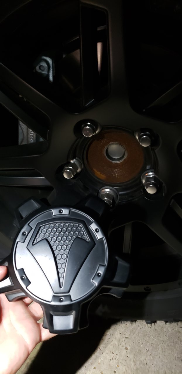

    Does anyone know how to remove the center cap?

    On mine (2019 TSS wheels) you just grab the cap firmly and snatch it off. It is held on by tension. Hope this helps.

    Thank you so much you just saved me a lot of time and hassle.

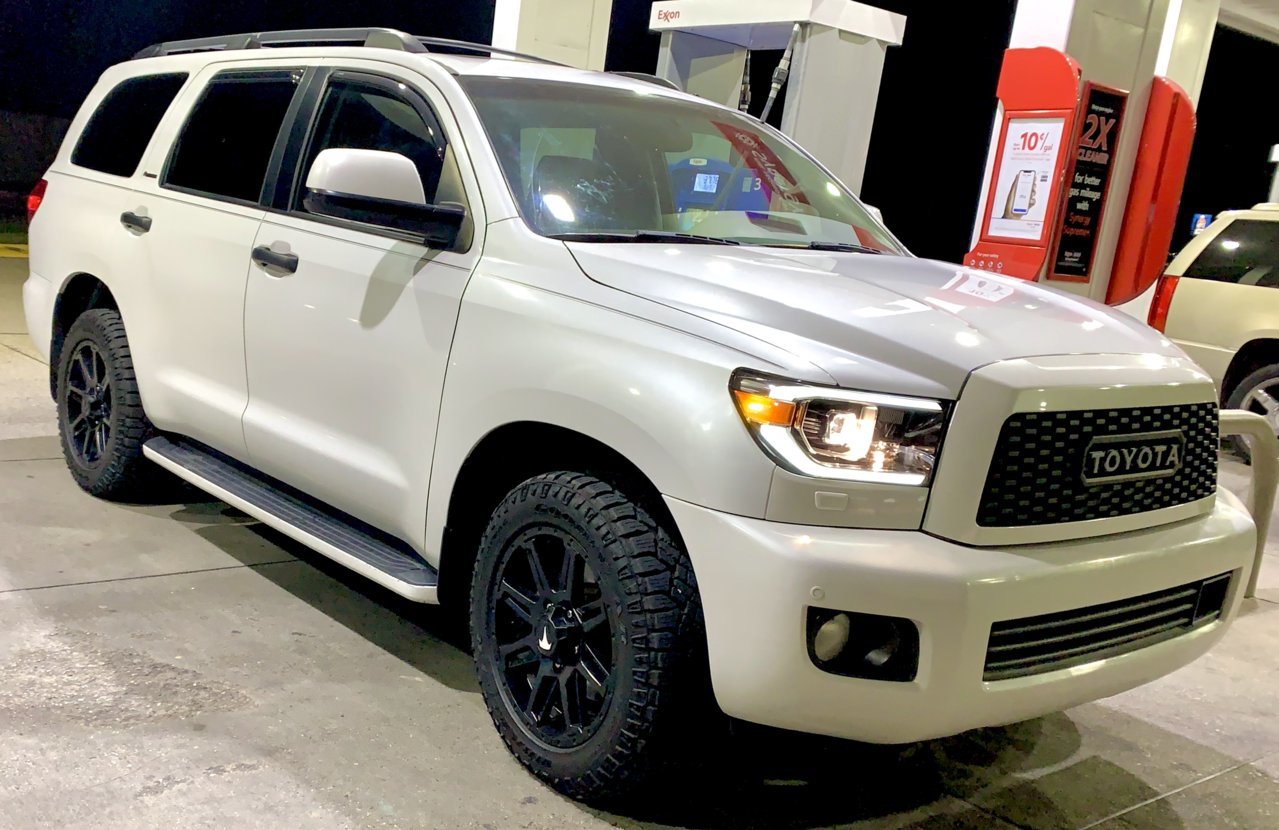

    You’re welcome! What color are you painting them? I put some white vinyl on mine to do a proof of concept but never fully committed and ended taking it off. Red rolled across my mind as well but I could never commit on that either. I’m interested in seeing your outcome!57EA682A-F57F-4480-8151-E51817D3CCFD.jpg

    @Beau my photoshop skills aren't the best but I think red would look nice in your setup as well!

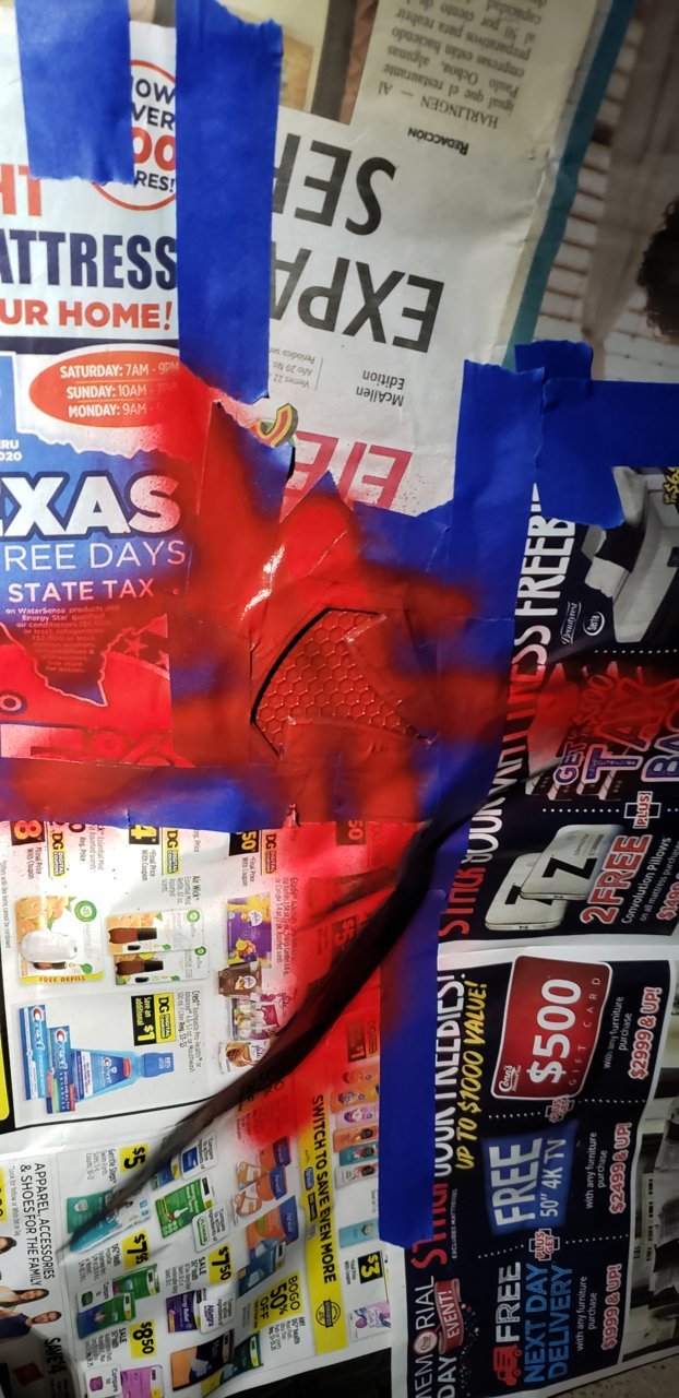

    Just take take your time let the paint dry well especially on plastic it needs at least 5 to 7 days. Don't do what I did, I had to actually do this twice the first time I was lazy to remove the painters tape as soon as I was done. I did it the next day horrible mistake as soon as you're done painting remove the masking tape so it doesn't lift any of the paint with it.
