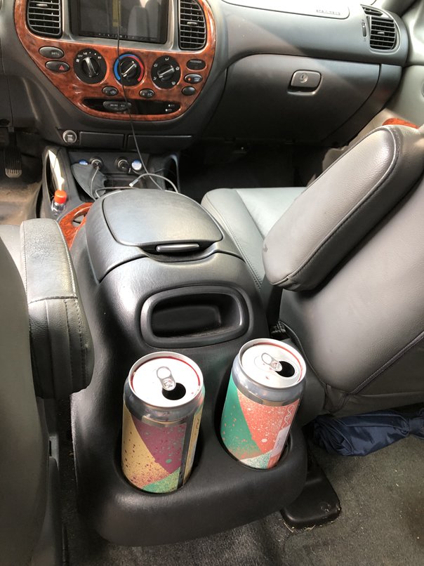

    You didn't put '1st Gen' in your thread title so you may get some really weird responses to your thread... :rofl:
    I'm trying to visualize the center console you have or don't have. Captains chairs ("buckets") in the later years normally have the long center console from back seat to the dash (see below), in one of two variations. Are you saying you don't have the full size center console but have buckets?!

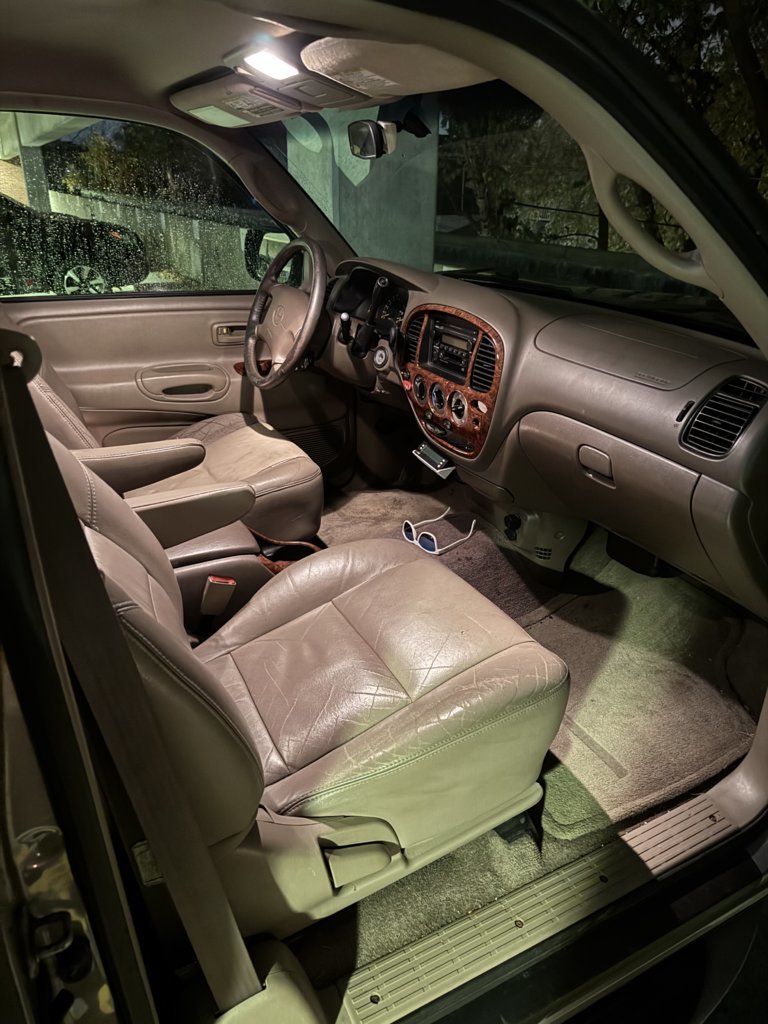

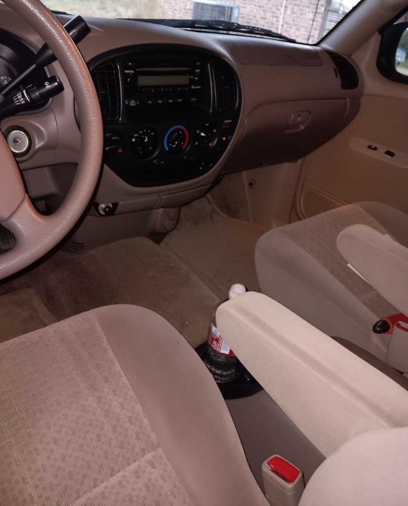

    Here's a photo of the interior space I'm talking about to clarify:

    How weird! I don't think I've ever seen that setup before. And the pattern on the front seats matches the rear seats?
    The ashtray charging mount I linked above would still work with your truck. There's another thread on mounts here. If you don't like it, see here: https://www.tundras.com/threads/1st-gen-tundra-phone-mount-solutions.147682/
    If I were you, I'd hit a junkyard and buy the center console I have in my truck. You can nab one from a variety of vehicles (Tundra/Sequoia) in the 2000-2007 year range.

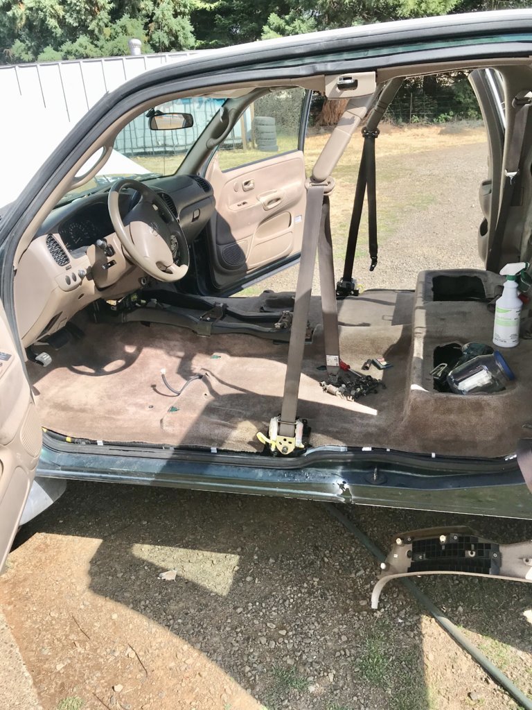

  6. Nov 4, 2024 at 3:04 PM
    Upshot Knothole
    Upshot Knothole New Member
    Sep 5, 2024
    #122480
    112
    Thatchery
    Outside of PDX OR
    2003 SR5 V8 AC TRD 4x4
    That console matches the one in my 03 AC with the 60/40 bench seat. Curious if someone swapped in those bucket seats or if that was actually an option.

    Yes, the seats match. As far as I can tell, it's a stock config. It's the exact same radio/center console as my 04 with bench. The transmission hump gap is just so much huger.

    I have that setup too. The lack of storage is annoying sometimes but it makes the cabin feel huge. Maybe it was a 00-03 thing? I don't think I've ever seen a DC with the short console.

    What the frack? Where's your console?

    You guys have never seen the short console???

    NM, I thought we were talking about a dbl cab...

    I feel like it's a RC/AC thing. I've never seen a DC with the short console.

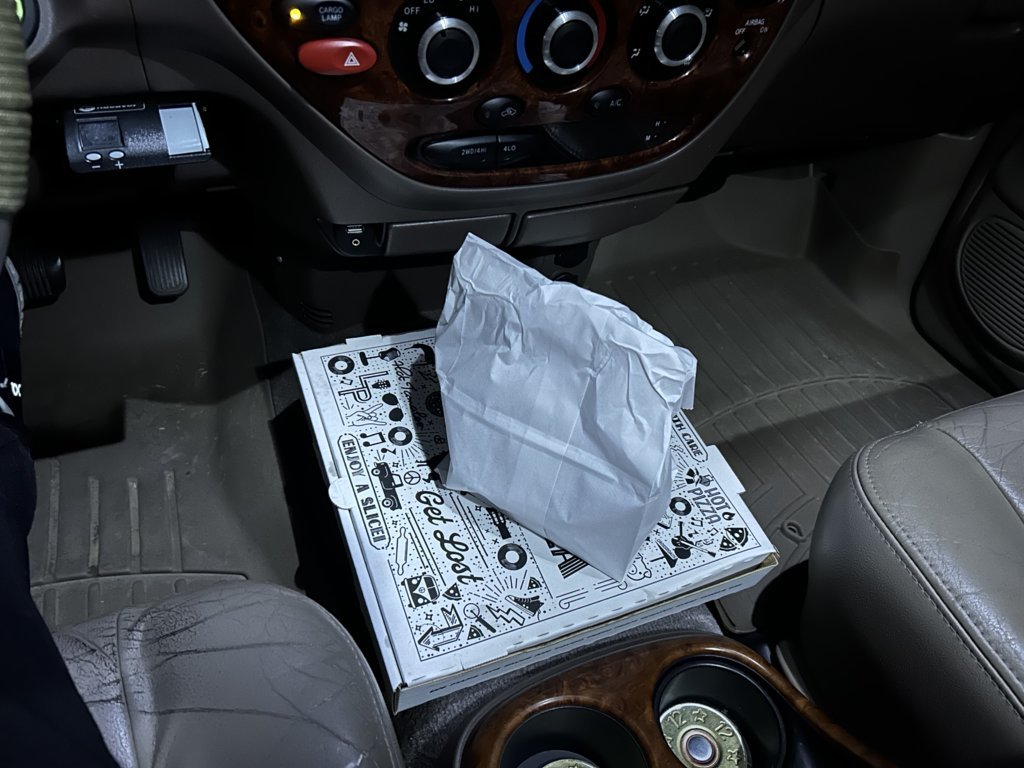

    Uh, that spot is for medium pizzas

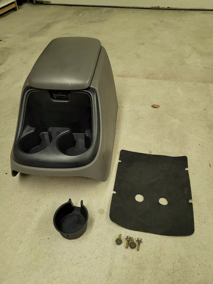

    If I were you, I'd look into the smaller center console @KNABORES and @FiatRunner have. It should be plug and play. It looks like this and sits back quite a bit, so you still have the entire hump space free and open for whatever you need/want. Pricing is pretty fair for them online, but I'm guessing you could find a salvage yard near you with one in stock for $40-$100 or less with all the hardware. 4 bolts to install it, the floor should be pre-tapped for it to fit. You can get it with a black center insert or wood center insert.

    and literally a matching pic (all the way down to the sunglasses) of my 2000 AC parts truck that also had bucket seats (not pictured).

    I have both 2000 AC and a 2004 AC. Both have bucket seats. The 2000 has the short console, the 2004 has the long console. I much prefer the long console! And if you find a long console at a wrecking yard, make sure to grab the two black HVAC ducts that route the floor heat to the back seating area. There’s quite a few different little odds and ends of brackets and such that you have to grab with the long console itself.
