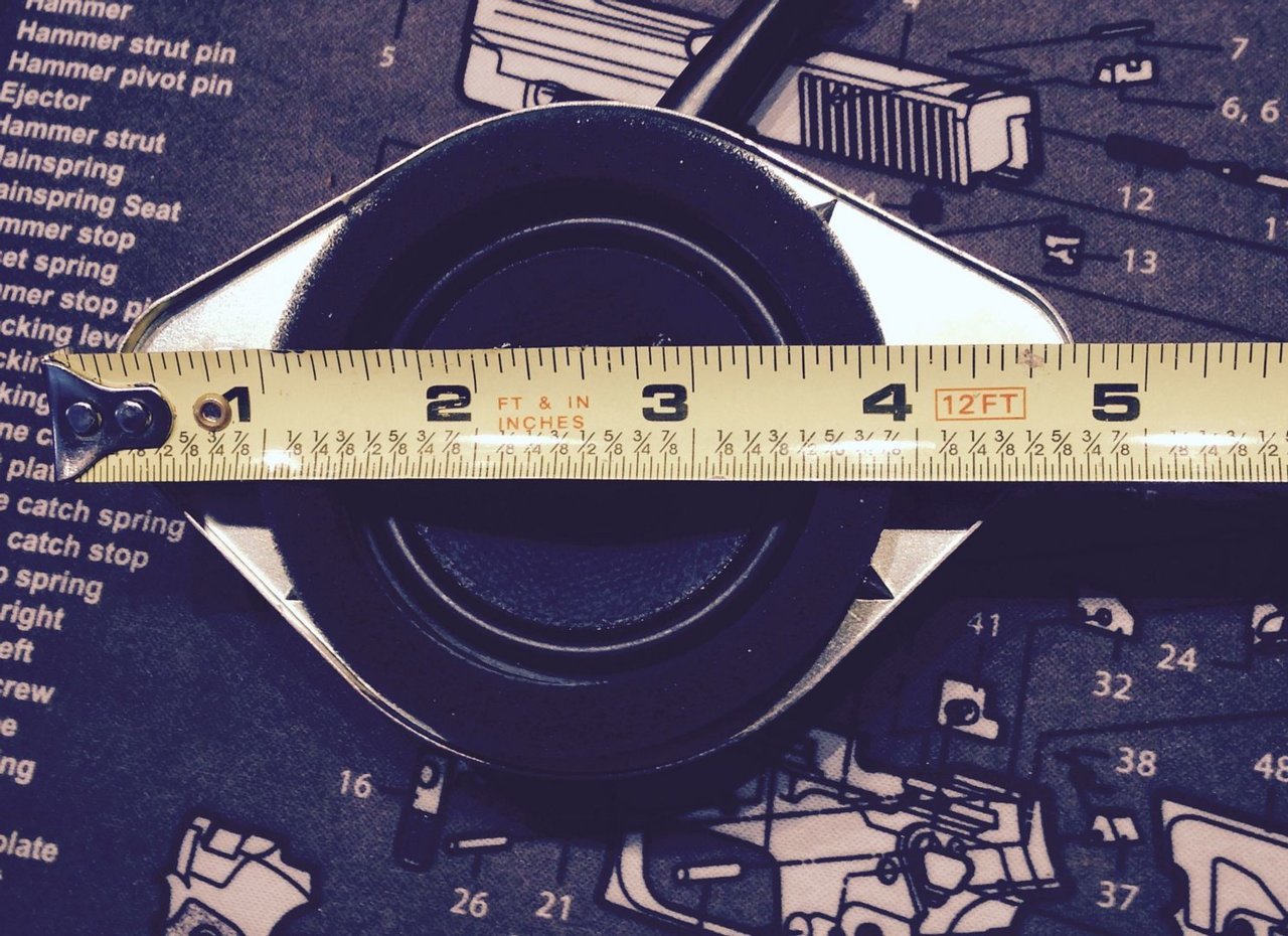

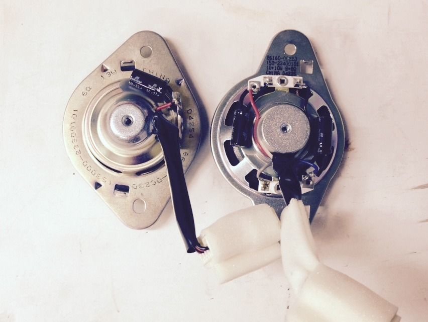

    I'm not sure about your 2008, but my 2014 non-JBL had a DVC center.
    The 3 dash speakers ran straight off the Entune HU.
    Signal goes HU, side, then to center.
    The doors ran off the underseat stock amp.
    The sides were 6 ohm and the center was 8 ohm + 8 ohm.
    2063C203-0B01-444E-9D08-304E75F398C4_zps_391e7ead6eb3fb9d75483db96c0e9162e24fa762.jpg 05B13A06-7BE4-4EB1-9829-DA521542621D_zps_cb307150d6adaf20bce820c59e4830b3bdab43d2.jpg
    I can understand you wanting to try it, I did it.
    But it was a waste of time.
    It sounded fine with the door components before I jacked with it.
    I also dabbled with the idea of 3 way components and putting the mids in the side dash spot.
    But that area is VERY small and it would take just the right mid speaker to fit in that space..
    A4D39AD3-635E-4703-827C-046E99F10003_zps_06e2e78debd99404e19bcf071cf30273c9a0a99b.jpg C7712717-D704-44E1-82A4-CBEFDCC60A8D_zps_7bcb78fbc8382cd6404e7dfd0fc63f1049315dae.jpg CBB62D5D-E6D8-4CAA-A7A4-9795DDD72C8C_zps_4b7bfc040429c92a7ac81e60142ed69c9cef23d7.jpg 261BCCAF-B521-49E5-A0C1-3646DA95BFE1_zps_50423a19fe36ddda3e22d2016ab86553c93093f5.jpg
