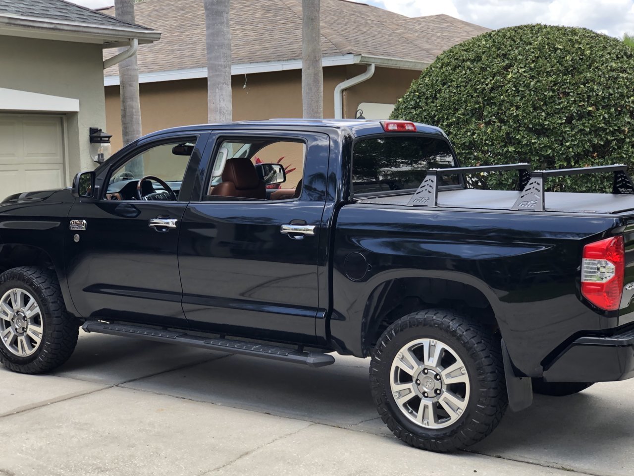

    49DF975C-0D88-46C4-9B69-64CC9EE51106.jpg 6FFE2BAF-EFD4-4519-8727-59F4428AB12F.jpg EFD9E3F9-313A-42B9-9CA5-A0BFECDBF0F7.jpg 132E8C17-7E75-4396-BAFD-AA296F3FE200.jpg 0CA8D603-9C6B-4668-A4B9-9D76EFA51910.jpg 96BD9ACF-FC48-4F15-8D47-1F29528559EE.jpg First, the CBI Overland Bars are awesome. Great product and SOLID!
    Do yourself a favor and buy them from CBI (or a retailer you know and trust). I went to a large online retailer and regretted it because the customer service was terrible and it took several weeks to get these delivered but it doesn’t take away from how happy I am with the product.

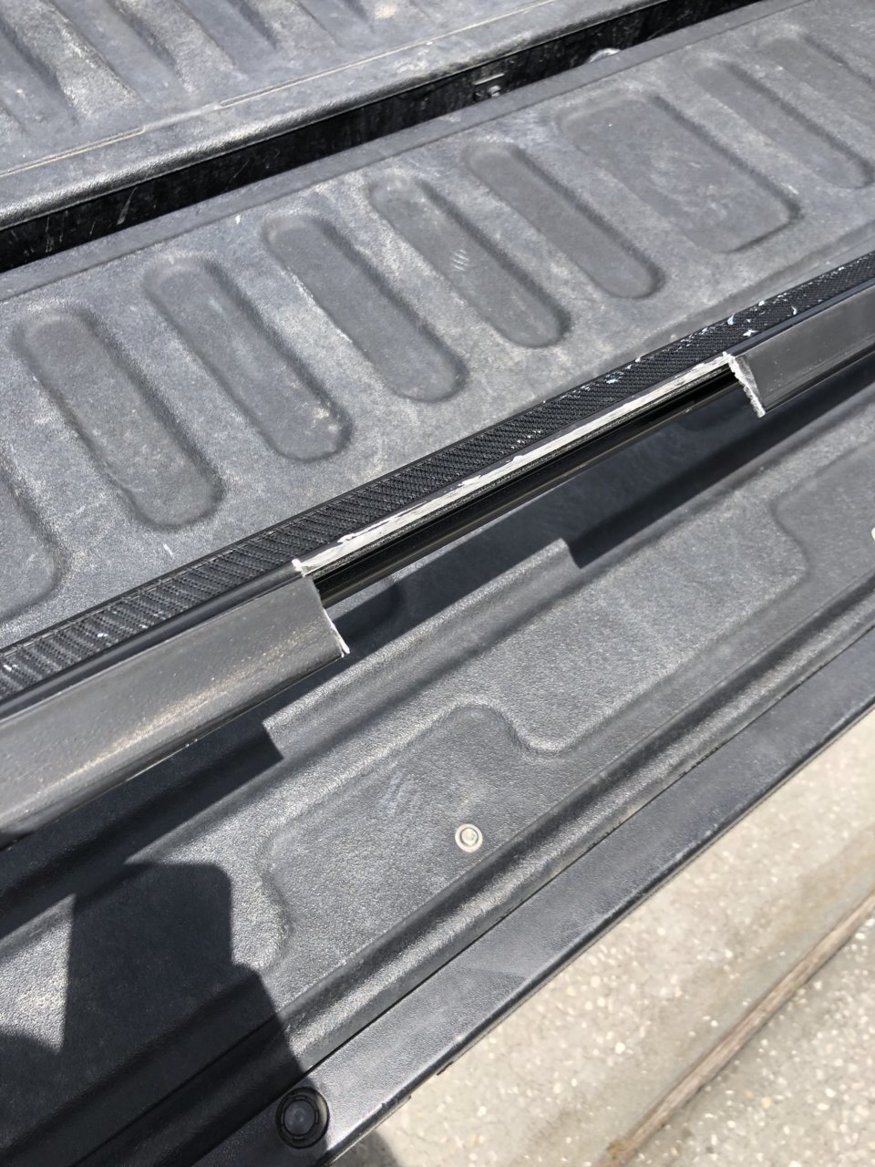

    I searched long and hard for a bed rack or crossbar set up that would work with my existing truxedo low pro tonneau cover and didn’t find anything...
    I really like the design of the CBI overland bars and took a long shot that I could modify my existing cover to make it work.
    The CBI bars are very easy to install on the existing rail system but the weight is distributed to the top of the bed sides which makes me way more comfortable putting a tent on it.

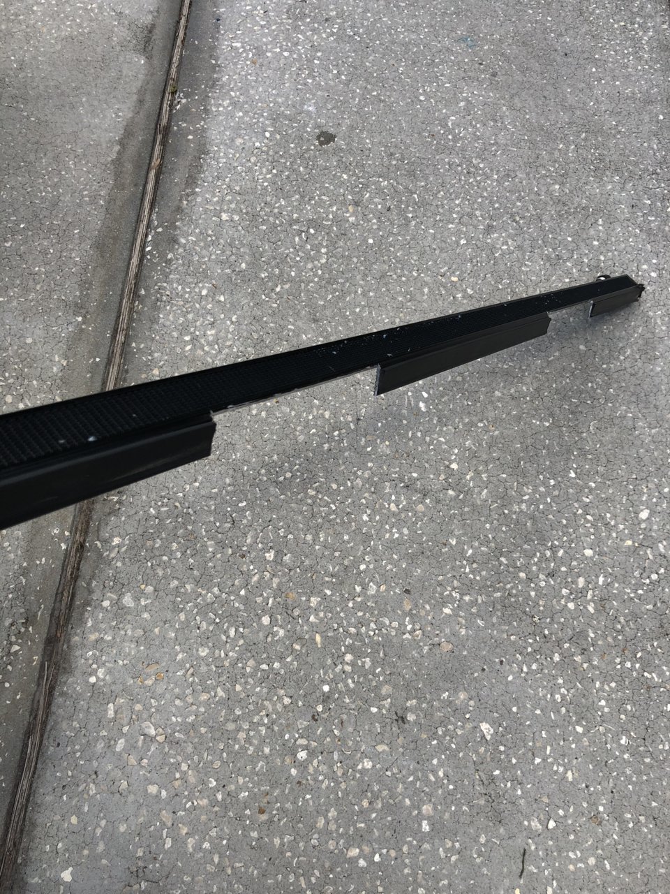

    it only took six cut off wheels on my Dremel to notch out the existing Tonneau cover frame and then we were off to the races.
    A quick shot of spray paint and back on the truck they went.
    I could not be happier with the finished product.

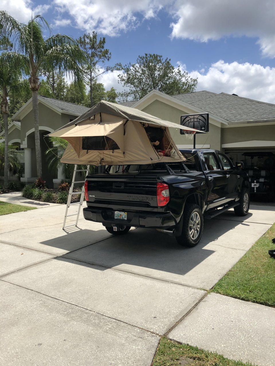

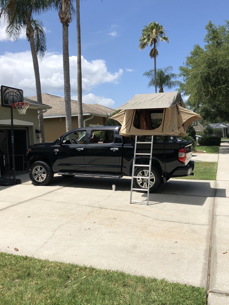

    Works well for the tent!688D62AD-C095-4204-B3CF-67F5C8803E03.jpg2A156DC4-1632-4EAE-AB08-48551B3EE410.jpg
