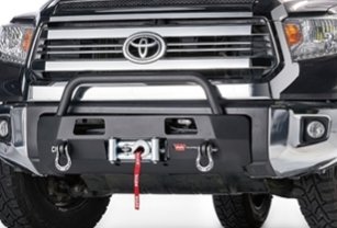

    This warn insert looks pretty good. I wonder if anyone on here has installed on their truck?
  16. Apr 27, 2021 at 10:33 AM
    Convertedman
    Convertedman New Member
    Apr 10, 2020
    #44856
    66
    Scotty
    Cumming, Ga
    2021 CM 4 wheeler Limited Cavalry Blue
    6in Ready lift, Toyo 35/12.50/20
    answered my own question.. Google is my friend. looks good.
