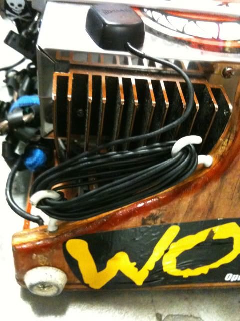

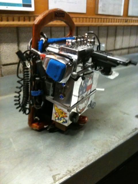

    My question is;
    Is it a stock CB radio or a 10-meter conversion?
    Converted 10 meter radios suck more amps than a 4-watt citizens band radio.
    Back in the day when I ran a CB, we used 10-meter converted radios.
    Galaxys, Presidents, Strykers, etc...
    Most had a small internal linear that sucked up a good amount of juice..
    We had them on boards since we would go from tractor to tractor sometimes daily..
    IMG_0751_9bba7b9304f587fd673eb3e16371b0e611ef960e.jpg IMG_0755_da6fa21d628accca8fb1a22475b4c6b32b0a6d29.jpg IMG_0762_3a2ca2f65b590ab4568c99025aa2ac46367833c6.jpg
