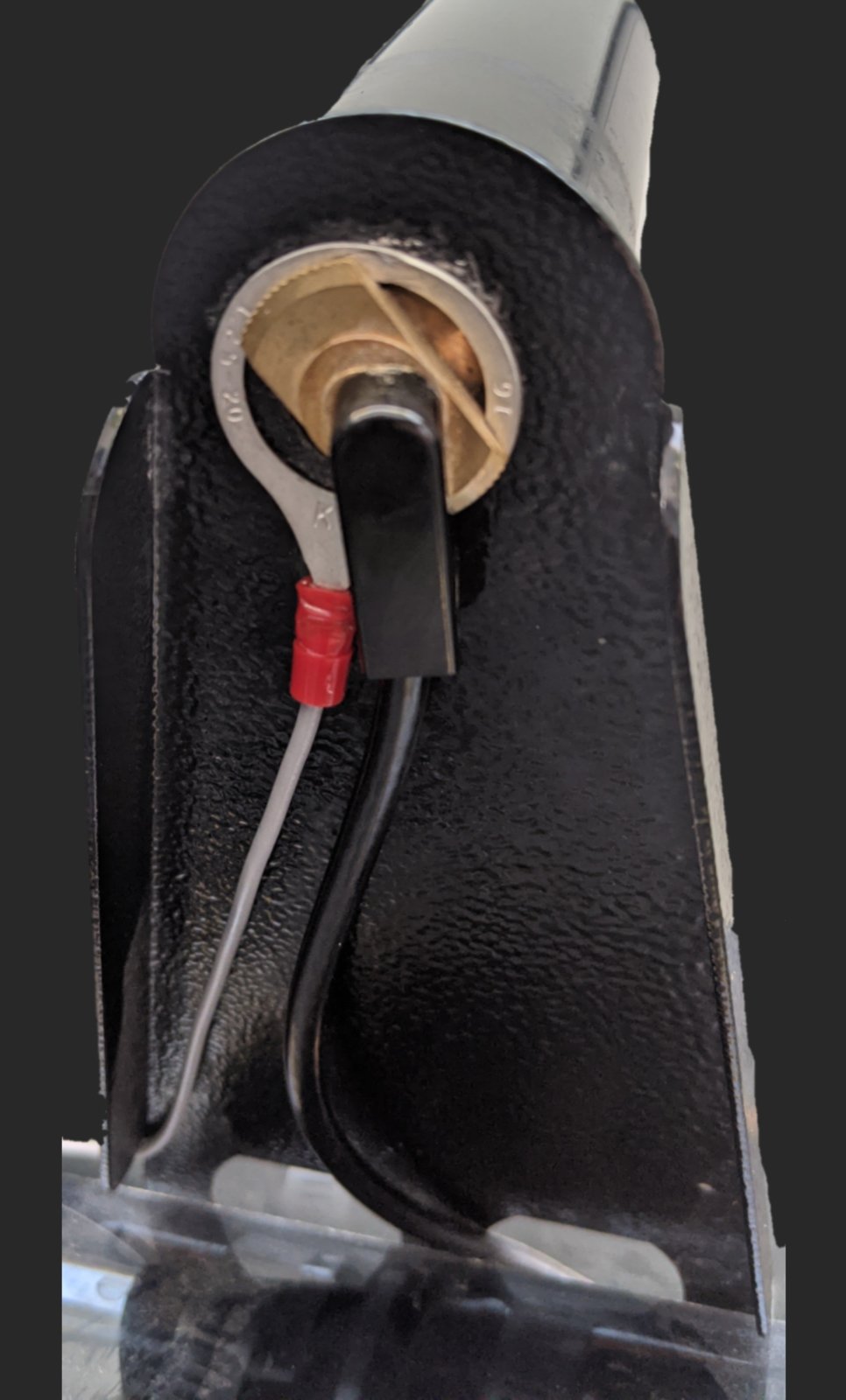

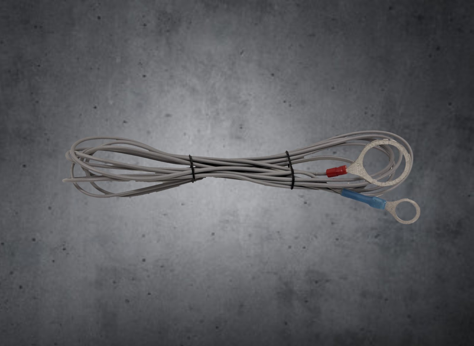

  20. Aug 13, 2024 at 12:52 PM
    texasrho83
    texasrho83 Old Member
    Mar 30, 2017
    #7025
    10,618
    Charles
    Conroe TX
    2016 DC MGM 4x4
    See build link
    Think I'll try one of these to see if it gets me a good ground.
