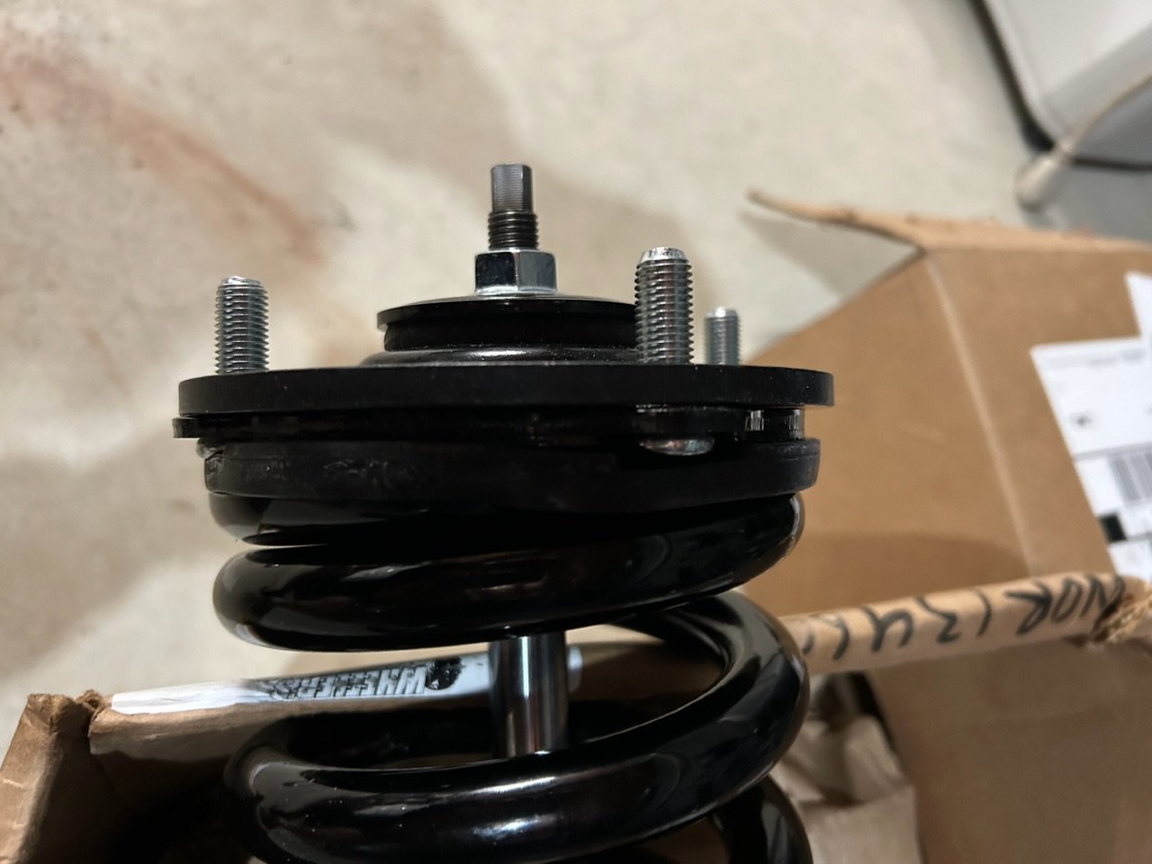

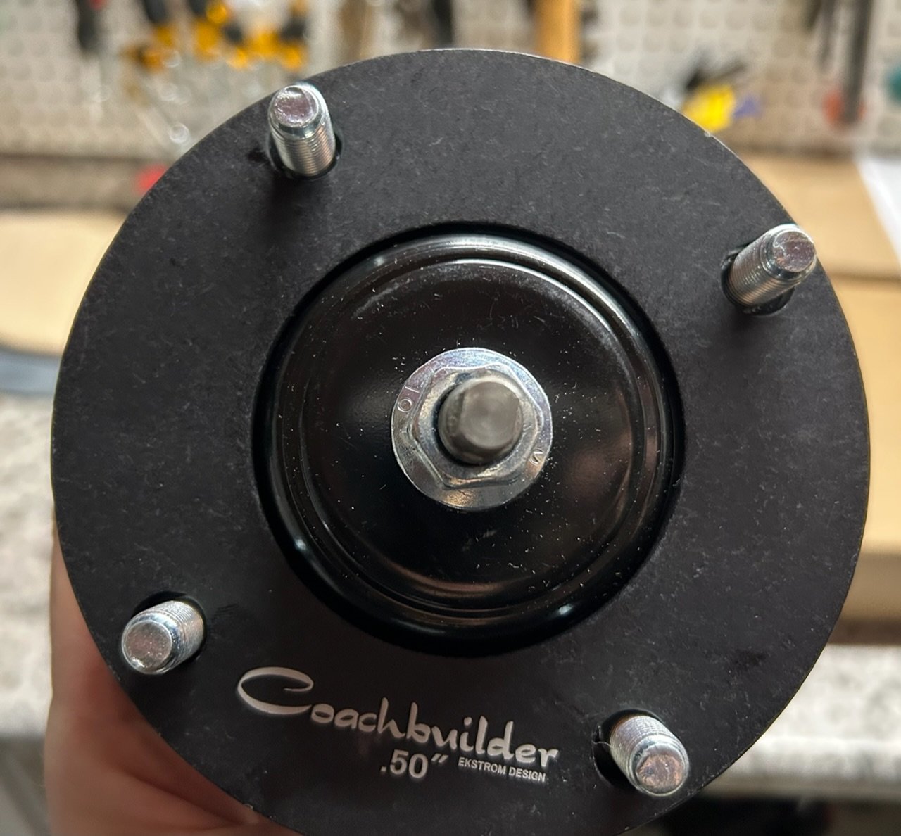

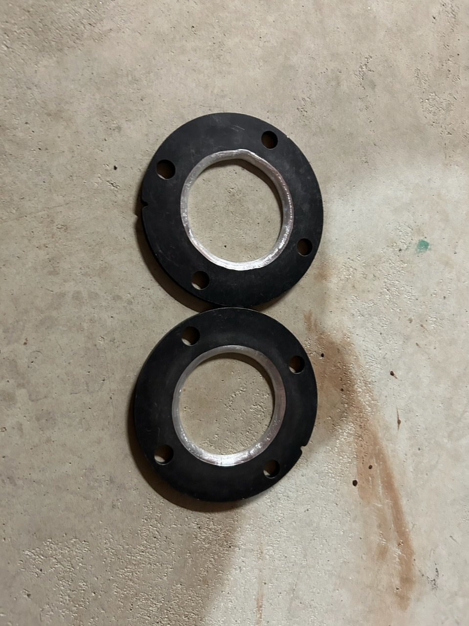

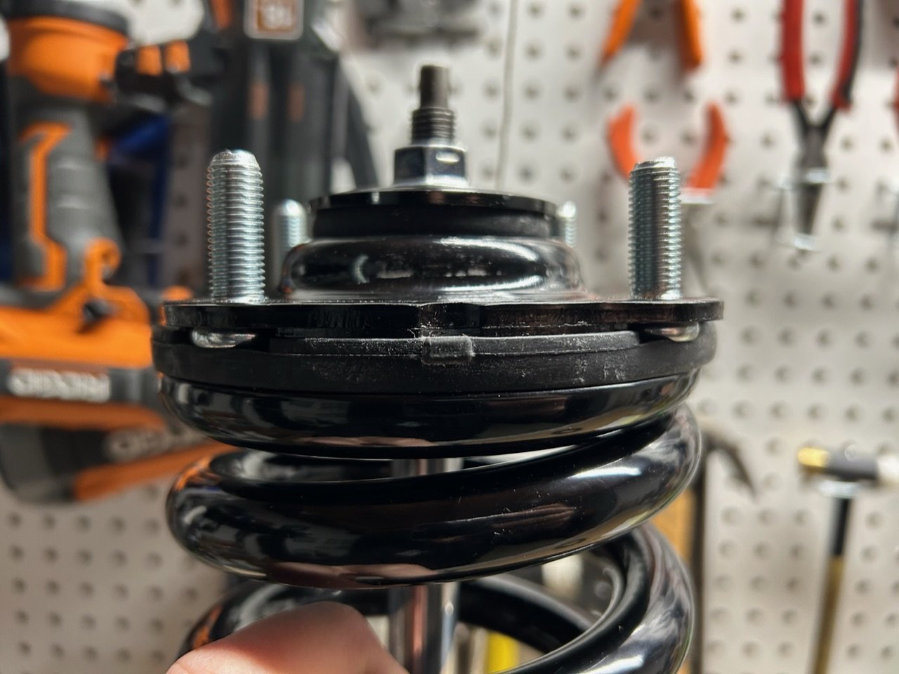

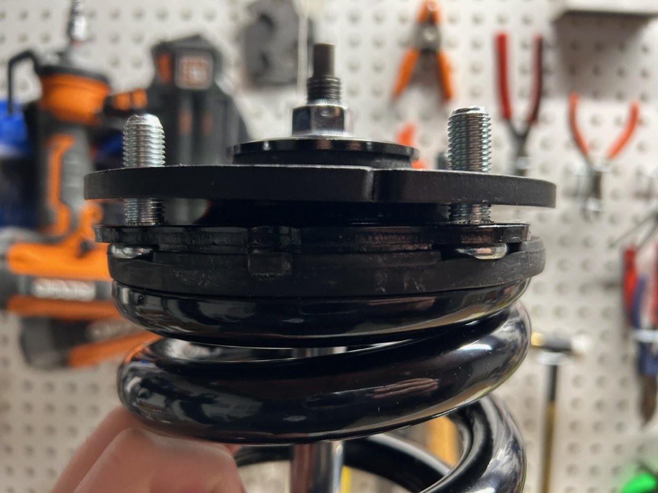

    CB shim doesn’t fit over the center of the tapered top hat of my fresh 6112s. Dremel out the center or try another brand ?
    edit: 1/4” round over bit solved it.

    I think the shim was designed around the TRD PRO shocks only (07-21?)

    Did you put it on right? Not trying to be an ass. I have them and the little cut out has to be in a certain spot for it to fit. So that means try flipping it over and spinning it. It will drop in when you have it rotated right.

    Yea it only went on one way. Tried all 4 positions to be sure.
