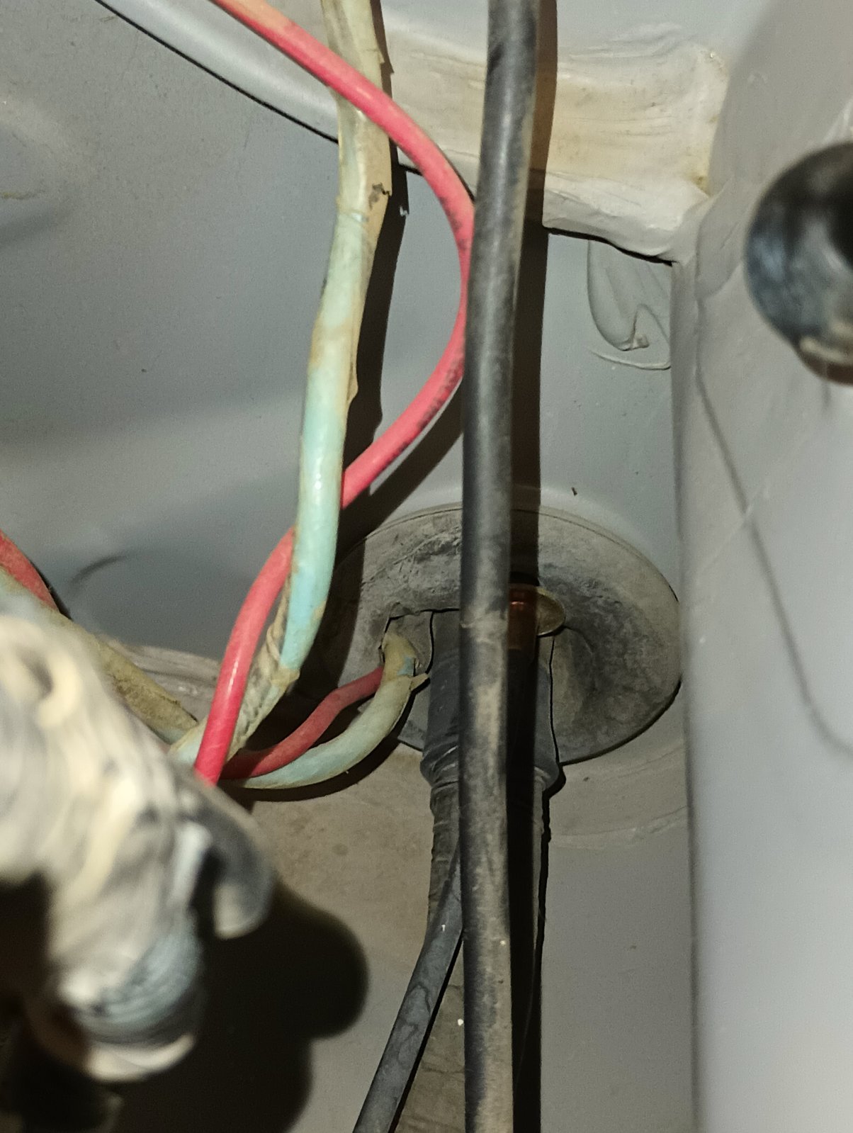

    I've been wanting a coax in my Tundra also for a ham radio install. I was thinking of going through a grommet on the fire wall that my electric brakes are using (drivers side). I would run the coax under the cab along the frame and up if I use a lip mount on the rear door, or maybe a lip mount on the left hood edge and then just into the engine bay.
    Here's a pic of the place the wires are getting through the firewall.

    Should work fine. Drop the coax down between the cab and the bed and secure it along the frame and run up to that grommet and through. Some pre-made coax assemblies have a pl259 that comes apart and makes the diameter to pass through a lot smaller. Re-assemble once through. Or just solder or crimp the connector on after you poke the coax through. That's what I'm planning. My biggest hang up is what lip mount to buy. They're pretty pricey. Good luck on the install.
