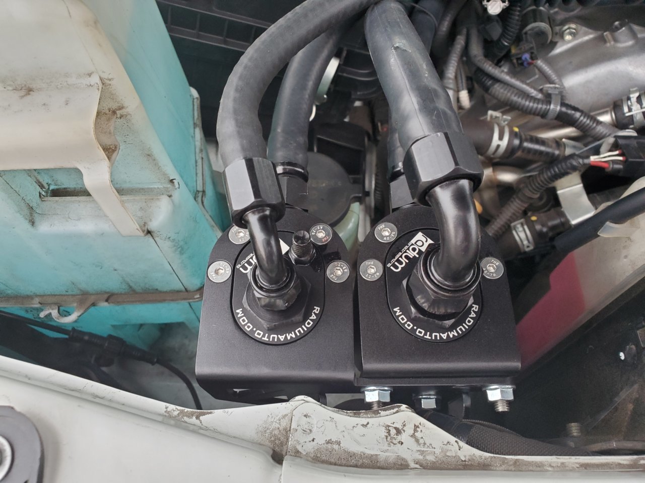

    Radium Engineering used here, but I'd recommend just their single PCV can. The crankcase can has been bone dry since installed and not really needed on our trucks.

    I run a radium catch can to keep whatever amount of oil vapor that gets past the factory system....to keep it off/out of my S/C.
