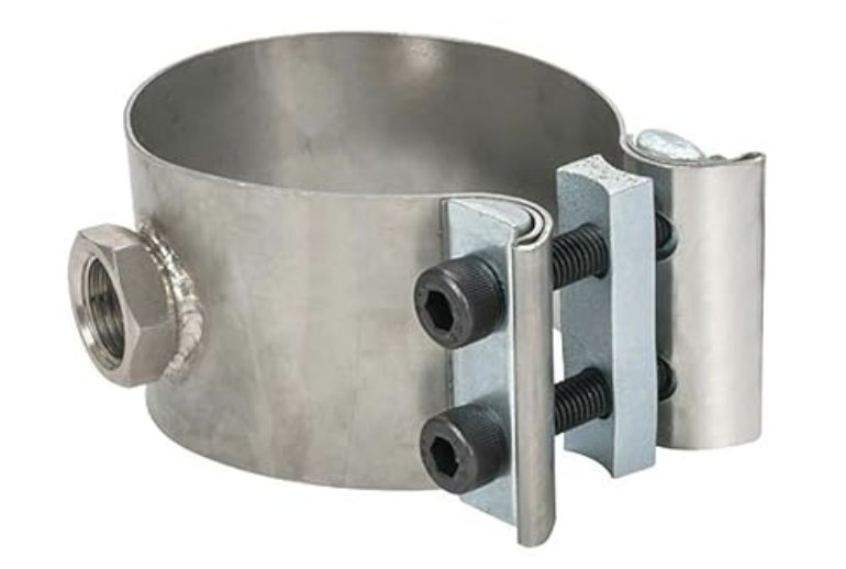

    • Could I block the O2 sensor port in the new cat and put a port further back (picture attached) ?
    • Would this fix my voltage fluctuations if the new cat was working as expected?

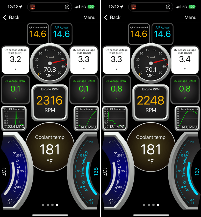

    Contrary to your information, typically my downstream fluctuate from 0.1v-0.8v on average (never more than 0.7v range), and the upstream typically sit around 3.3v on average, rarely moving once up to operating temp, never more than 0.1 at a time, if ever). This seems to conflict with what you're writing. See my ODBLink dashboards below to demonstrate that range during normal driving.
