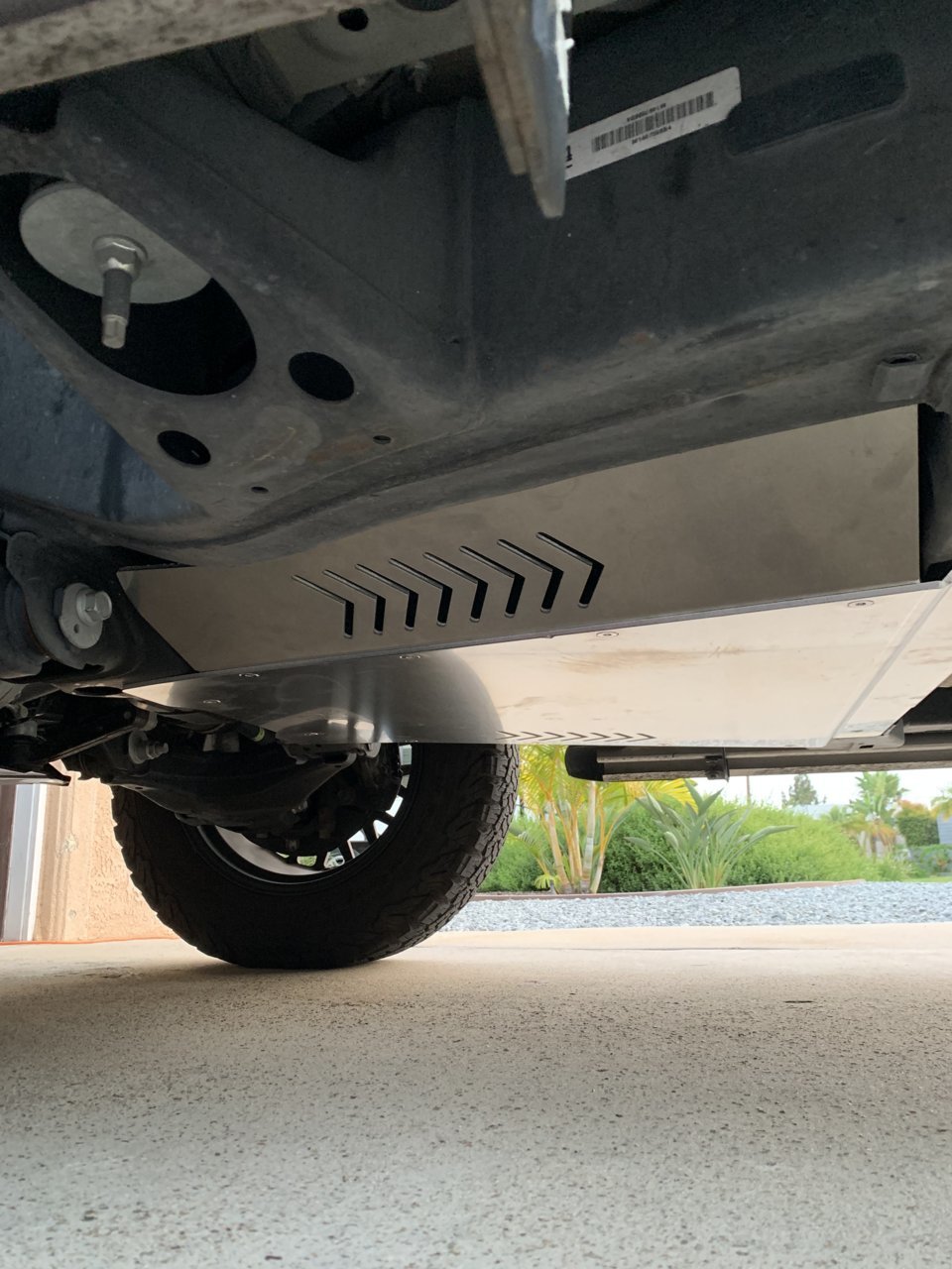

    Just finished installing the Millercat cat plate on my 2019 limited. Pretty straight forward install. Really happy with the quality. 03580DCE-E72E-489E-9878-2FBF7E096693.jpg

    How does this work in conjunction with the factory front skid plate?

    Looks good! whats the thickness and material?

    You need a rear plate too.

    3/16 aluminum
