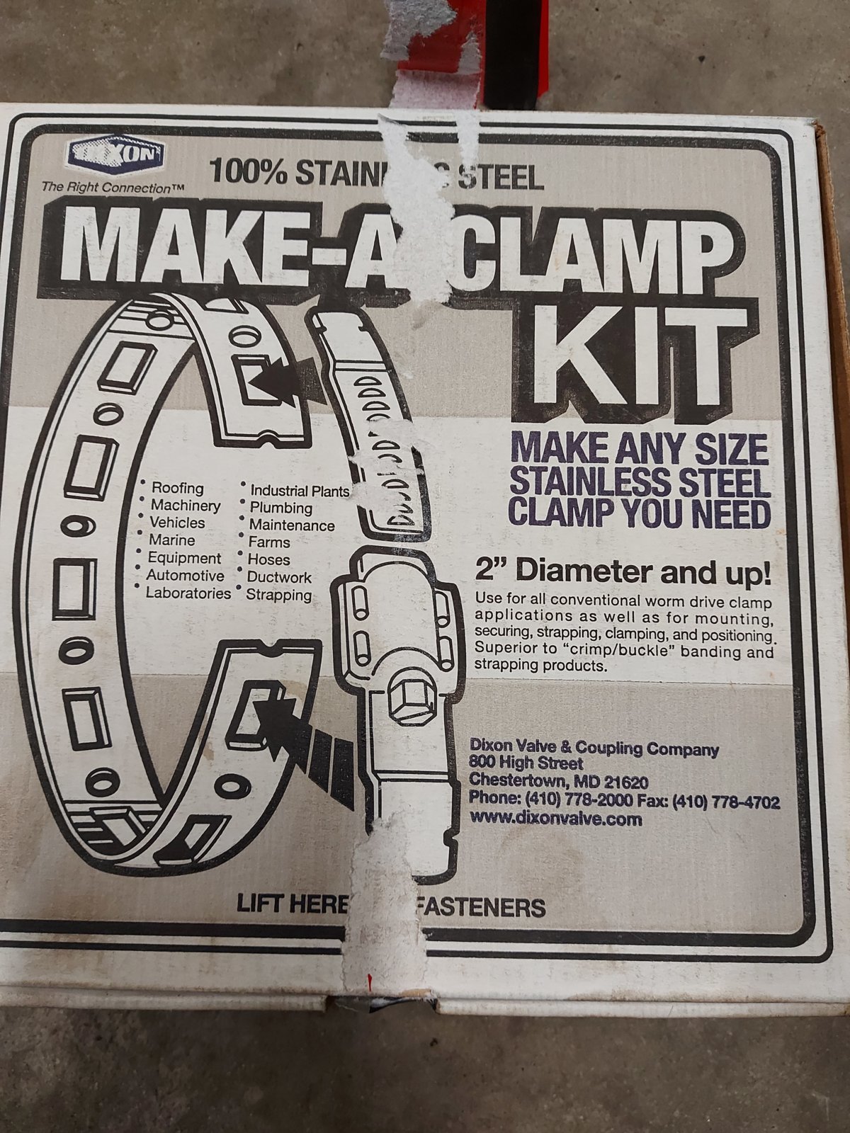

  9. Dec 28, 2023 at 5:10 PM
    TRXTER
    TRXTER New Member
    May 19, 2021
    #63268
    91
    Allan
    Ontario, Canada
    2015 5.7L Silver Sky Metallic Tundra 1794
    Just getting started.... Start X remote starter.
    I actually ended up using this custom length kit, it's like gear clamp on steroids. Peel off the custom length of clamp insert the 2 ends and screw together. It's probably 2x thickness of of a normal gear clamp, I haven't stripped one out to date. Then I bend back the extra and tuck it into where the gear is, so if it does loosen it can only pull back so much. I did it on my wifes Subaru Legacy too, a solid win !!
