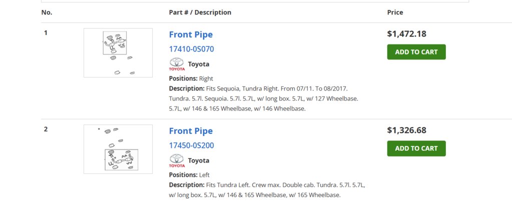

    Tunrod
    Tunrod New Member
    Jun 11, 2024
    #118267
    534
    Rod
    2021 SR5 CM 4x4
    Sparks Toyota
