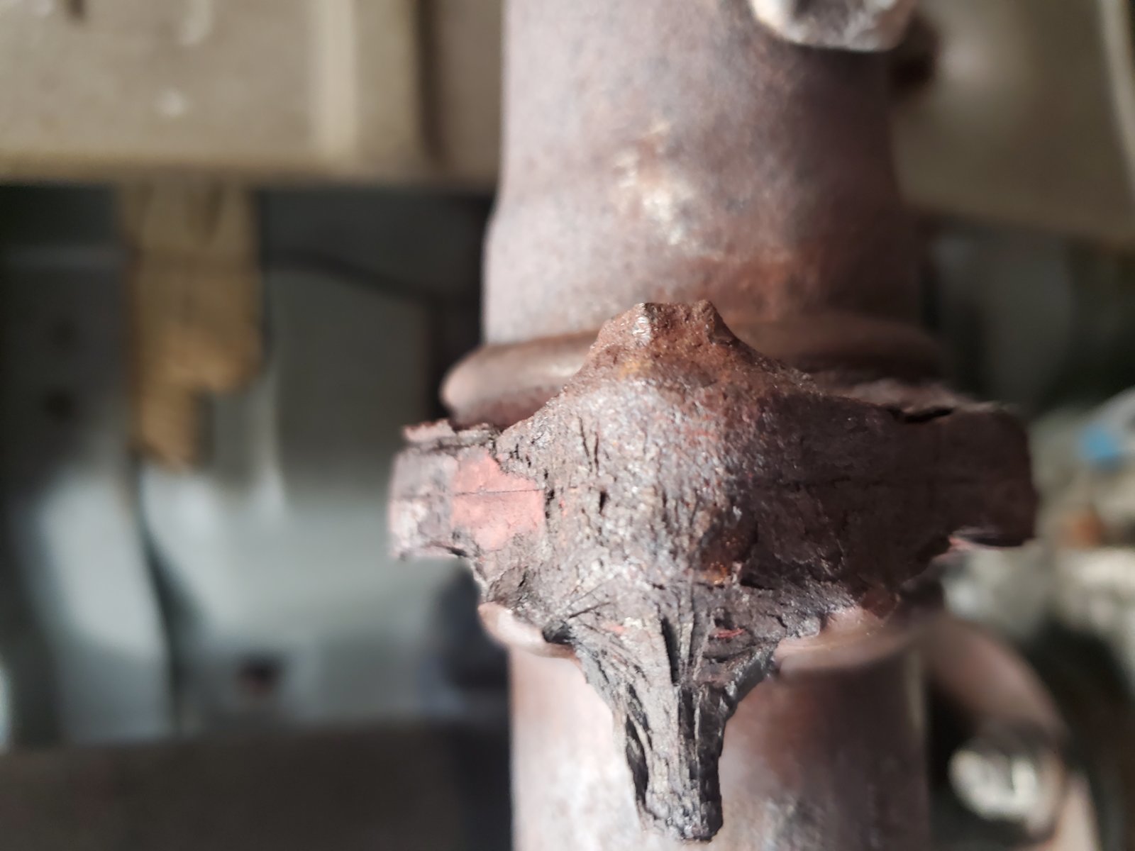

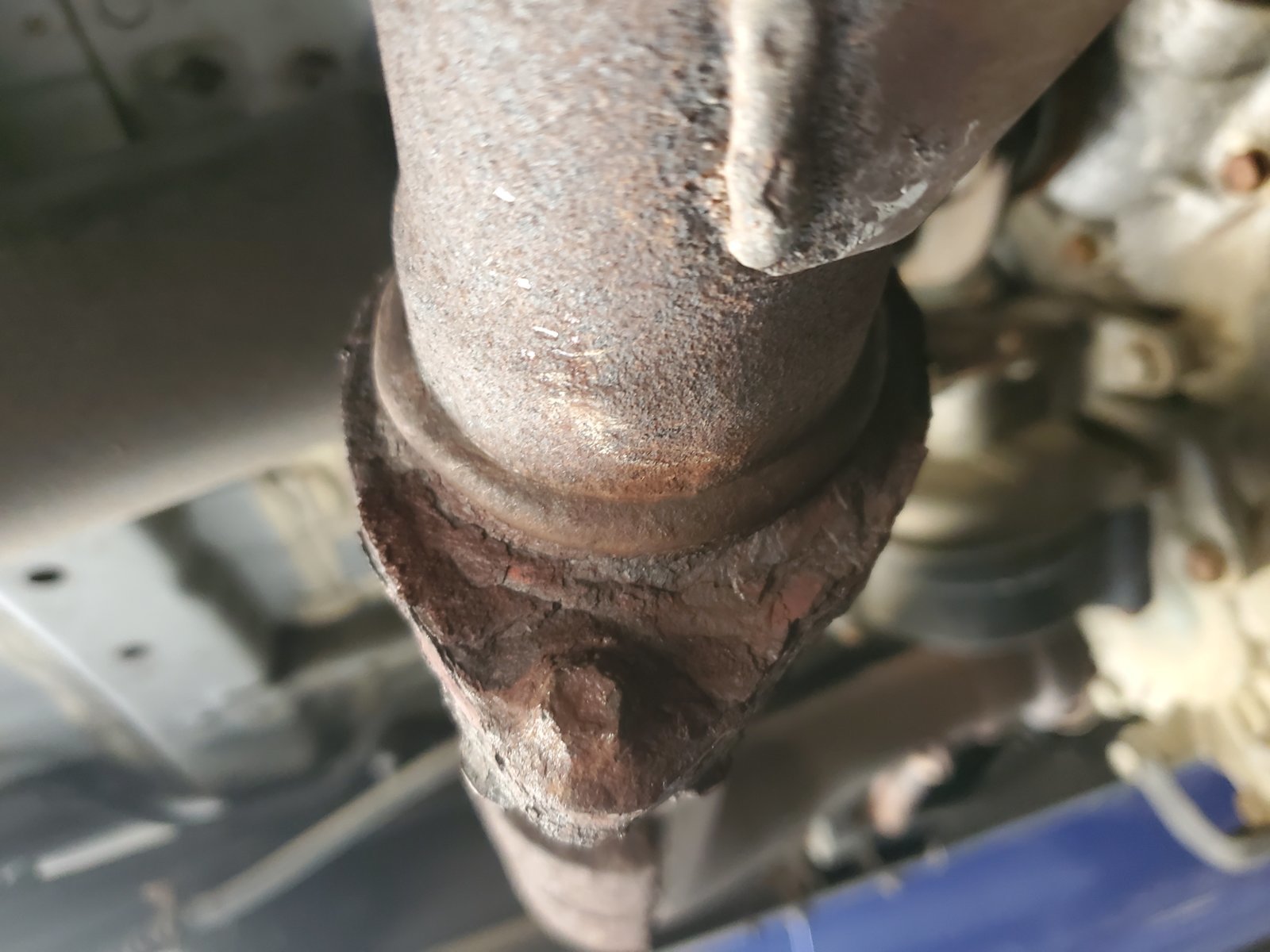

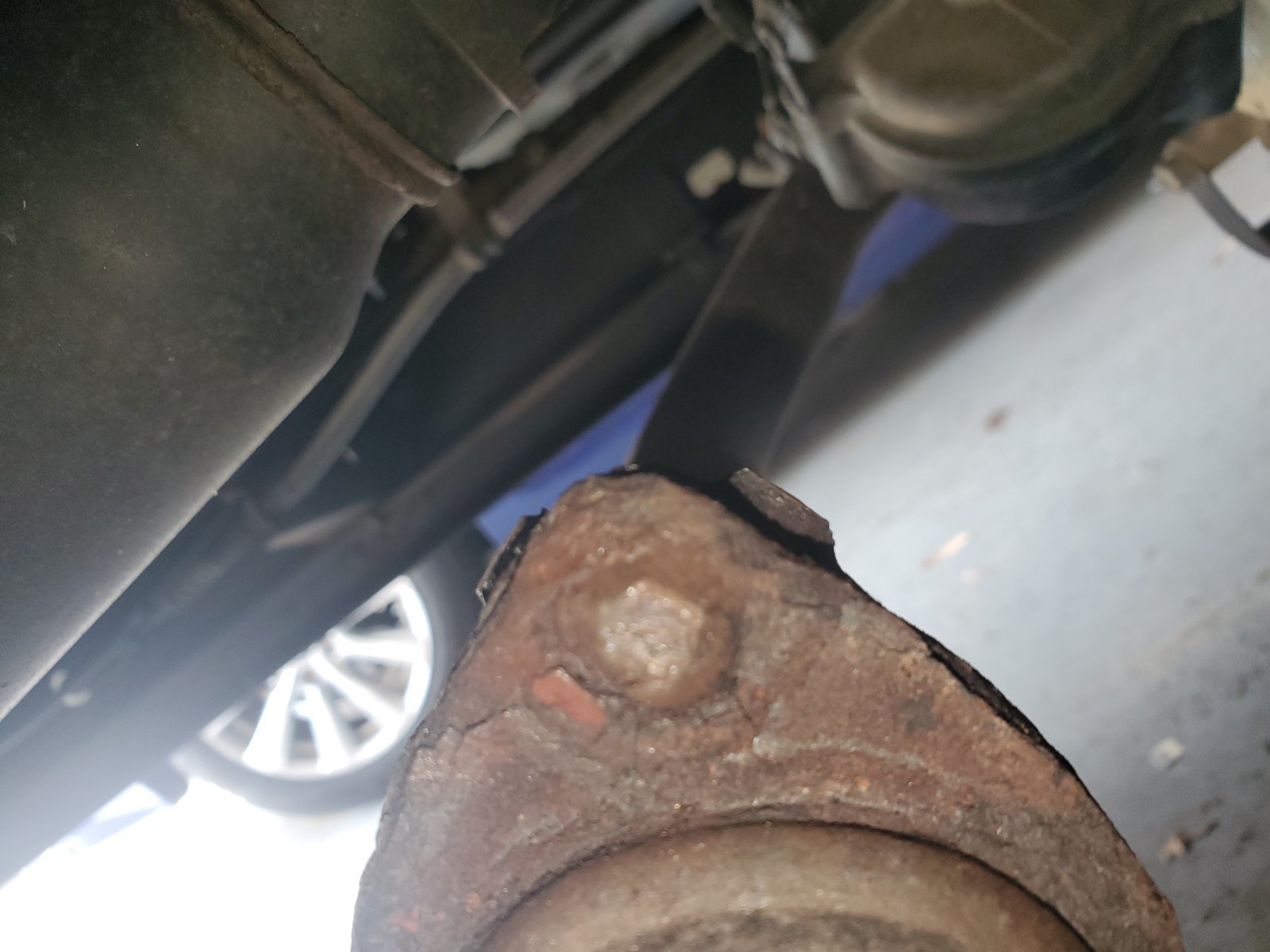

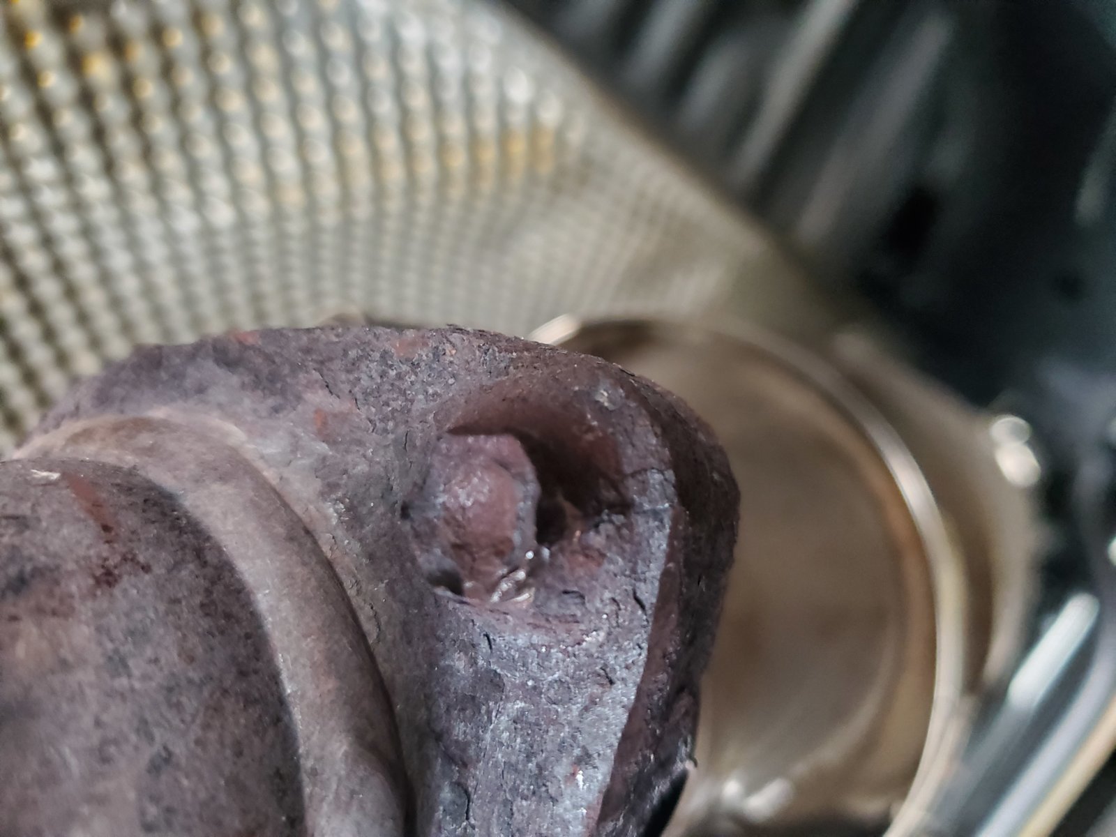

    I need to replace my cat back exhaust. My muffler is split wide open at the top, and the resonator is looking like it can fall apart anytime. I'm leaning towards ordering the bolt in cat back from Dirty Deeds because it also replaces the Y-Pipe section which looks pretty restrictive to me (weld in doesn't do that). I've been using penetrating oil on the bolt the last few days, and I used mapp gas on it this morning just to see if I can loosen them. I think these bolts are too far gone to use a socket to get them out. Any reason I can't use a 3" die cutter and cut the heads off along with the nut sections off the backs of these flanges when I replace the exhaust?

    Yes, that is what I had to do with mine. Cut them off, air chisel it out and replace with new ones.

    I used an angle grinder for that job. A couple bolts had broken off in the welded-on nuts so I had to cut my nuts off. :)
