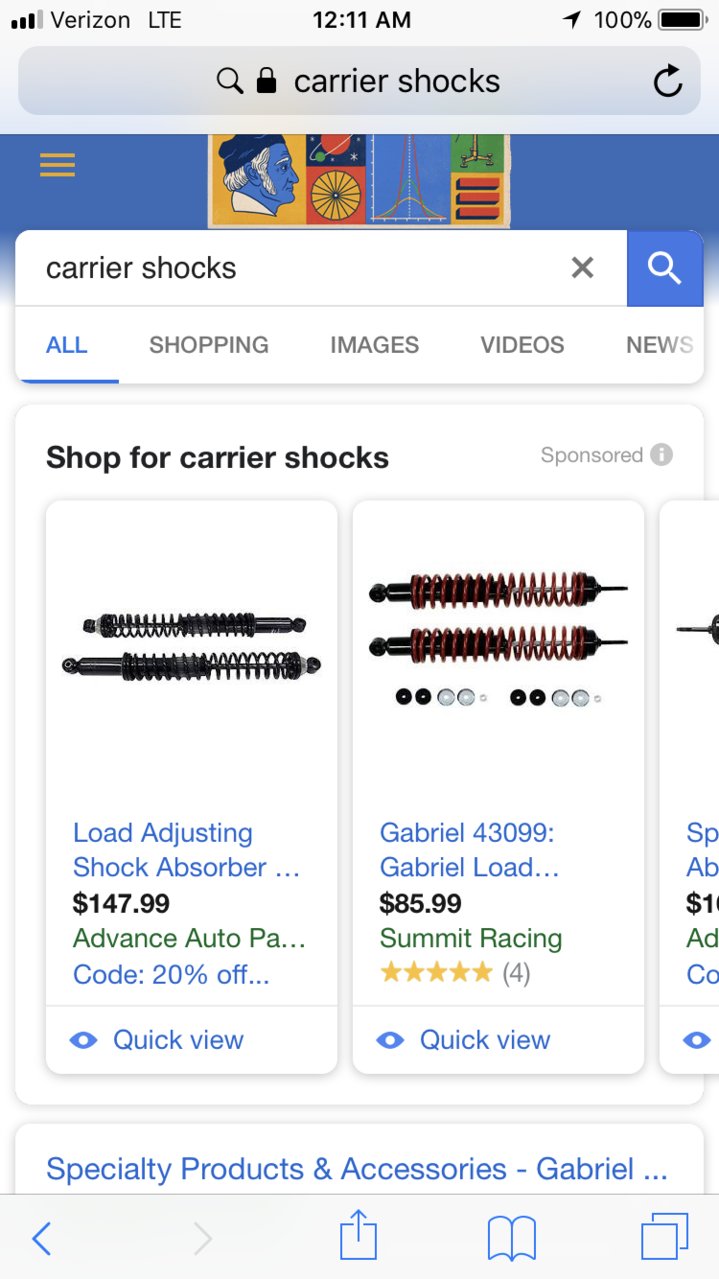

    Hey guys I have a 2010 that I just put a leveling kit in and I’m wanting to beef up the rear end a bit. My uncle put Menro Carrier shocks in his Ford . it looks good plus raised his rear in 1 inche and stiffened up the rear a little. I can’t seem to find anything for tundras. Has anybody installed an carrier shock on there tundra??

    From what my uncle said he lifted his truck and the front was a hair higher then the rear so he added the load carrier shock and it leveled it out. They are like a coil over just none adjustable but I can’t seem to find them for tundras.

    These say "load adjusting", not height.
    For Tundras you might wanna look at Bilsteins. Everything @Pudge said is spot on.

    Oh so carrier isn't the name brand ,it's a style of shock. They look intersting, kind of a helper spring (coil spring) mounted to a rear shock. I could see how it would add lift now that i see images. I've never seen them used or anyone use them. Leads me to believe there are some downside to them. I'd think they are very stiff and would make the bed pretty bouncy because it combines coils with leafs. Pretty interesting though.

    I guess you could crank up the "load" adjustment. My guess is they would be be very stiff.
