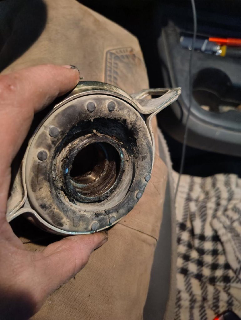

    Just wondering if anybody has seen anything that looked like this.
    And a little background
    When I first put my new tires and wheels on in February, it drove smooth as silk. There was a driveshaft related clunk at that time (ujoints/carrier bearing), but the truck drove smoothly at all speeds. Then I started developing some vibration and the carrier bearing needed to be replaced however, the previous machine shop had mangled the drive shaft. So I went with a reputable aftermarket driveshaft company that has been in business for 30 years that uses Spicer or equal quality U joints, and carrier bearings. 3 year warranty.
    This took care of the clunk and most of the vibration. I assumed the rest was likely the tires just needing to be rebalanced, but they have rebalanced with only modest improvement
    The driveshaft company has no problem warranting the carrier bearing but I feel like there's something else that play here
    I should've put the driveshaft on myself, but I did let the shop do it because they were balancing the tires. Supposedly, they lined up the driveshaft appropriately using the alignment marks. However, I've lost so much confidence in automotive shops. I cannot guarantee it.

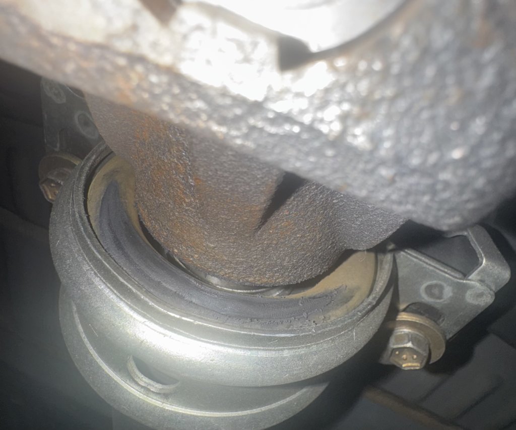

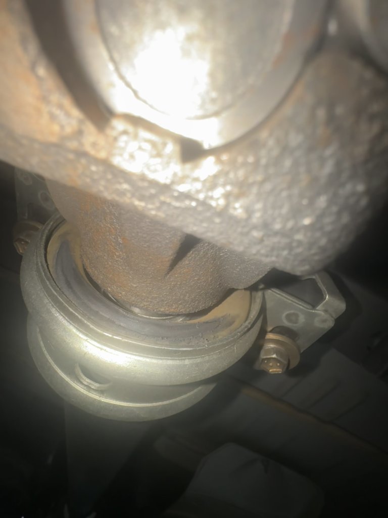

    When I was under there yesterday, I noticed this odd wear pattern on the rubber portion around the carrier bearing. Noticed the top part has some discoloration. The bottom part is black, but the rubber appears to be being worn away

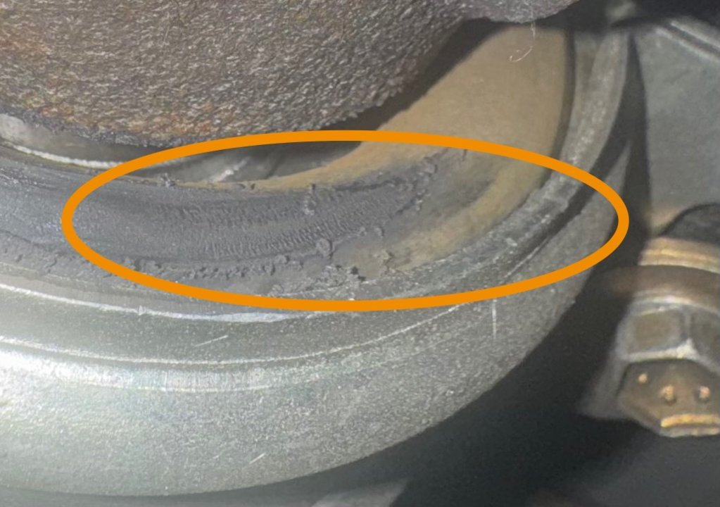

    From what I've read A vibration can cause that rubber to wear out however, it's only on the bottom portion
    and yes, the transmission bolts are secured

    If you’re still noticing vibration on the truck it’s a possibility that they didn’t press the u joint properly/all the way evenly. This can cause vibration and uneven carrier bearing wear.

    do you think that could cause the chafing of the rubber at the bottom? The vibration is only like a tire slightly out of balance

    Axle wrap i would suspect, axle wrap pushing the pinion up, and driveshaft forward, which is making that rubber a sammich between the metal pieces.

    Is that truly what's happening here? You're the first I've seen to have that weird wear on the carrier donut, though, so I hold an ounce of skepticism. Only way to know 100% would be watching it dyno while someone is cranking it, or to slap a GoPro or similar underneath to record the relationship between the driveshaft and carrier, bonus if it catches at least one side of the axle.
    I don't think this is pinion angle related at all, you'd be feeling vibrations if it was. Axle wrap would make the most sense.

    Axle definitely wrapping, and pay close attention to the driver leaf pack i nthe video when you gun it, see how it's flexing beyond horizontal to the ground?
    If you're seeing wear where the rubber donut on your carrier is making contact, that's likely the cause. Remind me, original leaf packs? How many miles if so?
    I was taught anything under 4-5° with leaf packs is tolerable but half that or less is ideal. I don't have any experience with the 1st gen Tundra on the topic though.

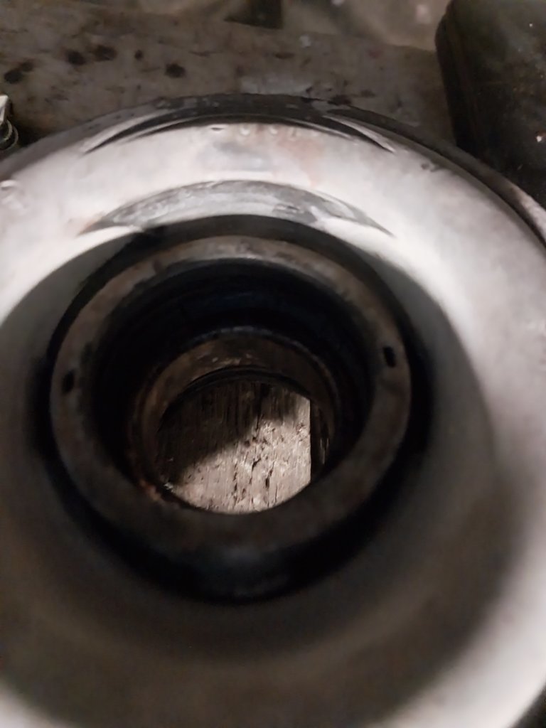

    Recently bought my truck, has a rough country lift with 2" blocks in rear and 300k miles.
    I replaced the OEM center support bearing a few weeks ago, it had similar wear on the rubber. I replaced it with an oreillys one with a bunch of 1 star ratings, and it's already gone to shreds, worse than the OEM. (Pictures r upside down. Wear is on bottom, not top.)
    Put on a replacement oreillys one again last night, but have a Spicer coming next week when I'll also delete the lift kit.
    I'm hoping just removing the lift kit and new shocks will keep it from wearing out again. But it'd be cool to see what's going on under there.
