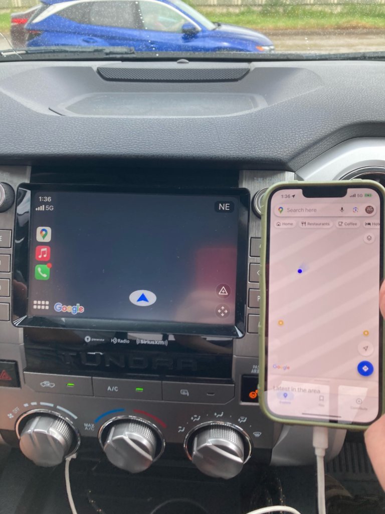

    2020 Tundra SR5 with wired carplay. Was working fine until I had to replace my Iphone 6 with an Iphone SE. After setting up the new Iphone, my google maps and Apple maps will not display correctly, they will display properly for a little while then the screen will go black except for the direction arrow. When I plug in my wifes Iphone SE with the same cable and running the same version of Ios 17.6.1 hers works perfectly. I actually returned the Iphone SE and got an Iphone 13 and it's the exact same problem. See pic below. All other settings seem to be the same. Any ideas? I have tried different cables, same results. I deleted the Tundra from Carplay and reset it up, no change. I wiped the phone and re-set it up still same thing.

    Have you tried resetting the Tundra's head unit? I believe there's a factory reset somewhere in the menus. Might be worth a try.

    only reason i havent is that carplay works normally on my wifes phone. But ill give it a try

    I had a similar issue with my iPhone 13. It ended up working fine when I got a 15.
    but some things you could try-
    - turn the truck on and hold down both knobs on the radio and reset the unit
    - reset via the menus
    - hard reset via unhooking the negative on the battery for 5 mins

    Here what it ended up being. When setting up the new phone AT&T inadvertently disabled data to the phone. I had to call 611 and took over an hour to fix but it is resolved.
