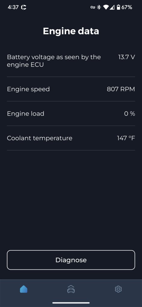

    cool.. Hmm interesting, I think I might do it. Need to monitor trans temp to do drain/fill. Also, would be nice to shut off some annoying chimes.
    Well.. no transmission temp. That sucks but at least I can control other options . Still a good deal
    I have the BT device already, I just need to sub.

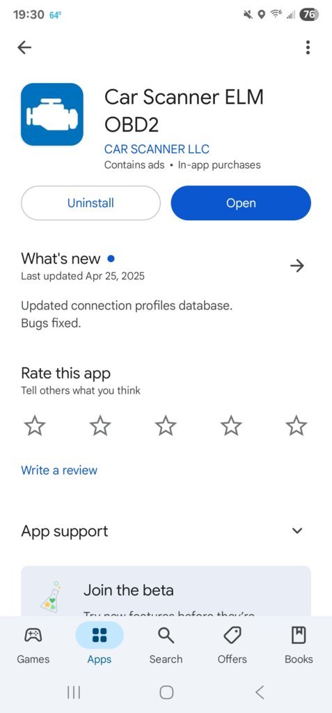

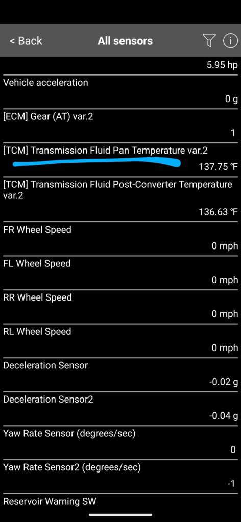

    You can use Car Scanner to monitor trans temp. Even shows up on the big screen with Android Auto or Car Play

    Why is "no transmission temp" on Carista? Mine show it.
    BTW. For some reason my Car Scanner app show transmission temp as "0" on Tundra. All other vehicles works well. Carista works on all of them.

    I don't see it carista. Shows only coolant.

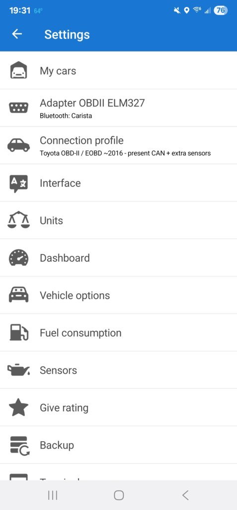

    It's an app. If I remember correctly, it was free for a month or so then did a one time payment of 5 or 10 bucks. Second pic shows the connection profile I'm using.

    Thanks, I don't think the Carista will support this app which means I will have to get me a generic ELN bluetooth unit. I use to have one but I can't find it anymore. Or just buy a dedicated scan tool.

    I'm using the Carista dongle. Works just fine:thumbsup:

    I see it. Bought the app. $5.xx lifetime. I also have torque pro too but I heard that one doesn't work if you don't have the PID.
