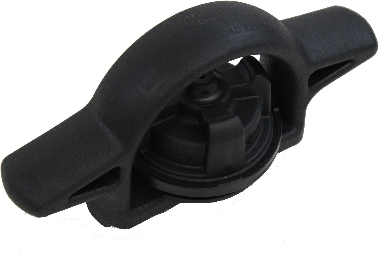

    Ok, cut each end off of the rails and they fit fine. My other question is there are 4 factory cleats 2 on each side. But what type of cleats fit the bulkhead cargo rail. Once installed you can't slide the factory ones in the slot. Is there a standard part out there to order that doesn't require pulling the rail? TIA

    Thanks for your input. That's the way I had to do it on the side rails. Man they sure are proud of the factory types. I may just get 2 and put the front on when they arrive.
    Just noticed that the ones below are 110 lb rated and are for the Taco but they do fit a Tundra. The 220lb version that came with the rails are like $40+ each. Just ordered 2 of these guys. They should be fine as the span isn't that much across the width.
    https://www.amazon.com/Genuine-Toyo...AYMGHTRS9ZH&psc=1&refRID=85H0Q3Q52AYMGHTRS9ZH

    2015 5.7 Crewcab
