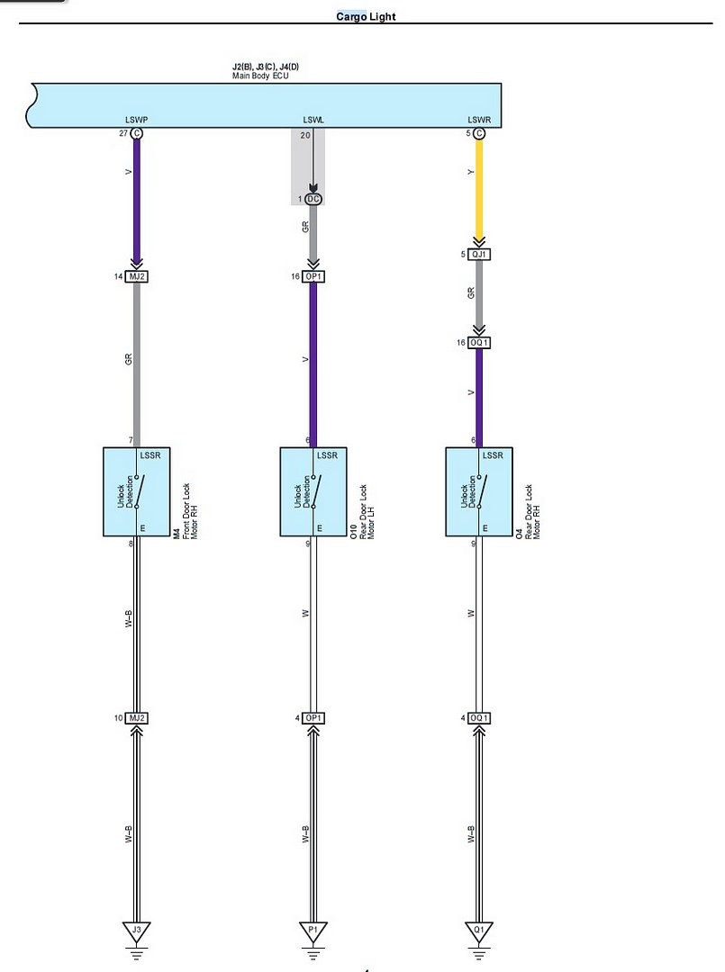

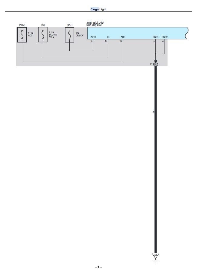

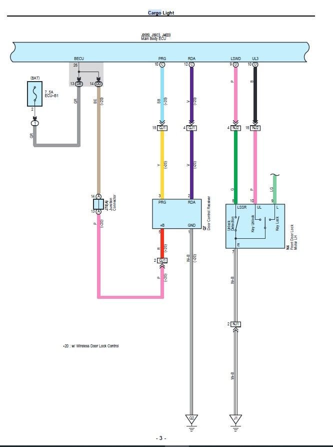

    Cargo light circuit is pretty complex..
    Controlled in part by the ECU I think.
    2015 diagram, maybe it will help you with your testing..
    cargo_light_4_0de90672ae889e4cd36e7dde4a5c0c6db159bae4.jpg (edited)_cargo_light_1_e0ecbc5afffb9e6a8fd0c5fd7e7b5772a3a1b3a7.jpg cargo_light_2_cb649e4b22eb77838f1ebe533244ef84dade1a7b.jpg (edited)_cargo_light_3_7c9dbd444b4014eb291970d3da17659d59ce72b9.jpg
