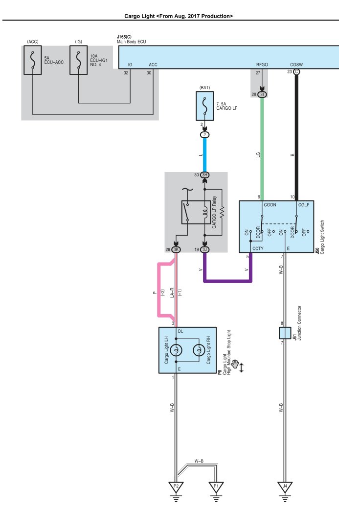

    The cargo light circuit is one of the simplest, fitting on a single page for the actual output. The key is to find pin 28 from connector 3K in the instrument ECU/Relay box (in a 2017 and older, it's a different pin on a different connector).
    Hijack that ouput wire and you've got the cargo light controlling whatever you connect instead.

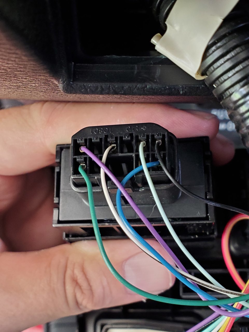

    Another way to do it (this is how the "factory" SE Toyota Bed Light kit is wired via the instructions) is to draw power from whatever source you want (in this case, they used the Cargo Lamp circuit, but direct from the battery), and then ground the load through the violet wire in the cargo light switch (see below). Functionally, it's the same, but it separates the source load (while still using a common ground) - theoretically if you were to use too much load on that circuit, you could cause issues with the cargo switch by overloading it.

    You’ve removed the load of the two filament bulbs in the cargo light. I don’t know what the load is off the puddles and the footwell lights.
    If it were me, I’d grab the output from the cargo light relay (pink wire on pin 28 from connector 3K out of the main ECU) for source power and ground it direct to a frame ground point. Leave the switch alone, but have the original switch function preserved.
