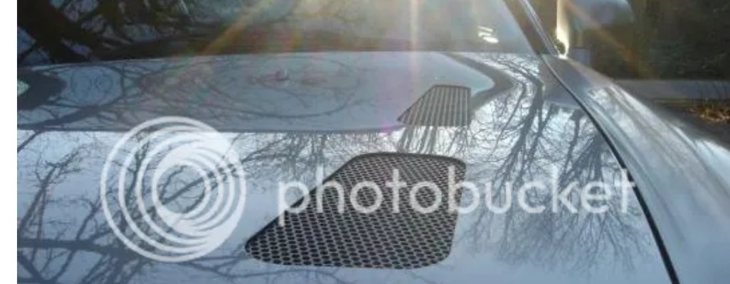

    I'd take advantage of the low pressure area at the front of the hood above the radiator. Place a reverse scoop in the center or 2 on each side above washer tank and battery.
    I plan on cutting out in between the framed areas above radiator area and installing aluminum mesh. Will pull air up and out and reduce lift. Easy to cover in the rainy season.
    Similar to this miata hood.
    Good luck and any air movement is good!

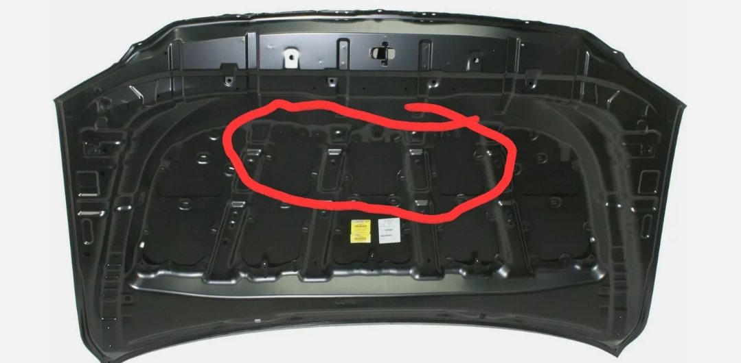

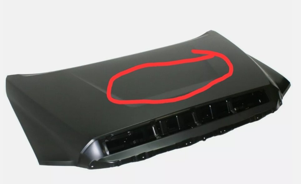

    I'm not sure if this is the 2021 hood that you have. It has a low pressure area that, to me, would be perfect for venting. I haven't seen too many with the forward vent louver design but whatever hood you like is what matters. I like trying to work with what I have.
    These areas seem prime for adding, low, and flush, vents or louvers. I've seen people use blue painters or frog tape to block vents or devise a diversion for under the hood.

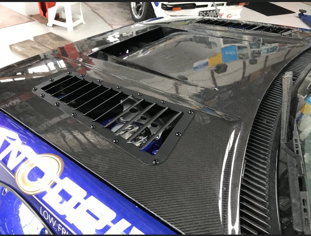

    I was chatting with these guys about this very thing
    https://racelouvers.com/tundra-08-23-center-hood-louvers-rst-truck-trim/

    Yea seems like it. I’d have that seibon hood already on my truck that we run on the old mans just need to figure out a blocker or something for the winter here
