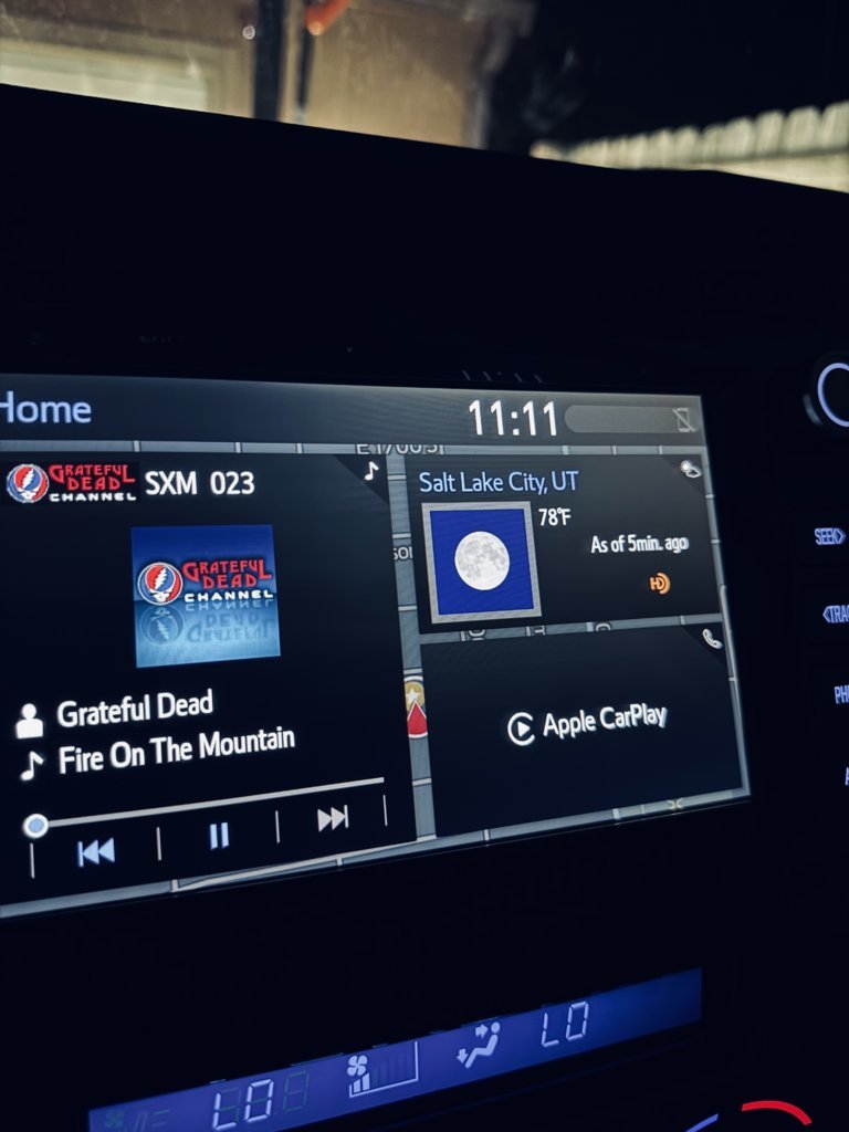

    The car play setting shows up on the Home Screen where your phone call presets are. Did you buy the usb port adapter? The head units are wired car play only.

    Ok. I just press the car play area on the home screen and it’s activates car play. My auto harness house wiring harness is working great. Using the wired usb port as well. Maybe the a connection is loose or a pin is bent on the harness connecter. I never had to turn on a car play setting on my iPhone, it just connected automatically.
