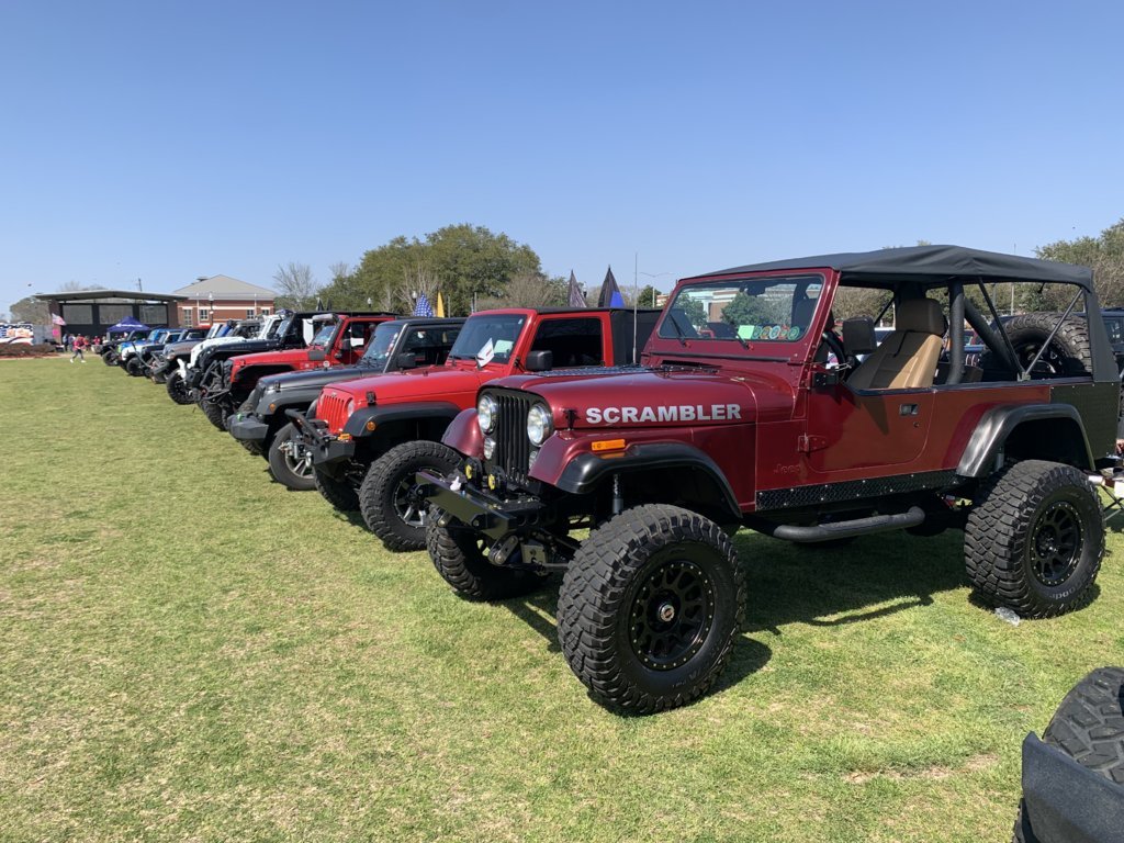

    I’m considering finally picking up a trailer mainly to haul my 1981 Scrambler occasionally, and wanted to get some of your opinions.
    According to the local Cat scale it weighed in at 4960 lbs with 2 people, full tank and tool/jack kit in the back. I estimate 4500 lbs without people. Another consideration is the width, it’s around 81-82 inches wide counting sidewall bulge.
    My main questions are 7k or 10k capacity trailer? I think I’d be borderline on weight for a 7k especially if I had anymore weight to the rig like a family cage, winch, etc.
    Removable fenders or drive over fenders? Most drive over models seem to make the whole trailer wider which means heavier overall.
    Thinking 20ft would be max on length, unless anyone suggest other wise. Thanks in advance for any insight.
