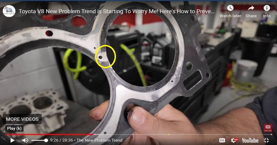

    Ya'll might want to watch this one. I always thought the Toyota suggestion of the first coolant service at 100k and then every 50k was odd. I just did a 60K service last week. Coolant looked good, but after watching this, I know what I'm doing this coming week.
    https://www.youtube.com/watch?v=dfGTI0sWozc

    Cliff notes: Old coolant gets acidic and eats away at the steel head gasket, enough to create problems, specifically around cylinders 5 and 7 for an unknown reason. If the engine overheats, the aluminum block can warp. Due to how they are constructed (aluminum cast around the steel sleeve) they cannot safely be machined. A new block alone is $6k. Change your coolant at 50k/5yr intervals to help avoid.

    All Toyota engines that have this type of head gasket.
    The Video title is misleading. IMO
    The video example is a Land Cruiser with 200k Miles.
    Coolant becomes acidic and wears out the black coating providing a new path for the coolant to enter the cylinder. Seems the coating is the only thing preventing this.
    In the pic you can see the coating has been wore out and the hole is where coolant travels.
    Change your coolant as required to prevent.
    He also did say that the 3.5 engine design would leak on the outside (floor) if this happens not on the inside like this, which is not as bad.

    Thank you. He mentioned the car was in for rodent damage near the knock sensor. Could the knock sensor have failed to sense a pre ignition condition? That too can do some damage.
