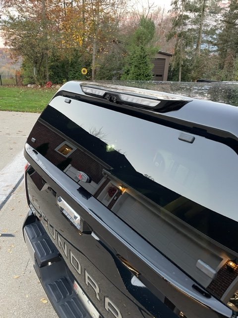

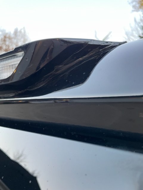

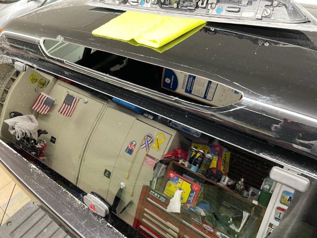

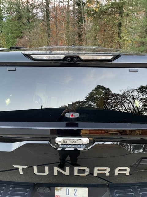

    New to the forum-- I have a 2023 Tundra and purchased the Leer cap-- I bought the harnesses from GGOffroad--- they work great. I took it to the next level and bought a cheaper version of the 3rd brake light assembly from Toyota (the one without the cameras) - put that on the cab of the truck then moved the original one with the cameras to the Leer cap-- It did take a lot of modification-- like cutting a hole in the cap and adding epoxy or bondo to the fixture to make the angles right. But it looks great and with the harnesses from GGoffroad -- everything is working. see pics
