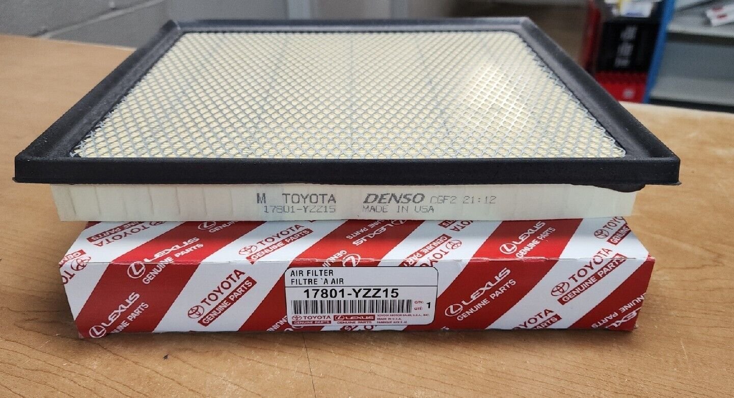

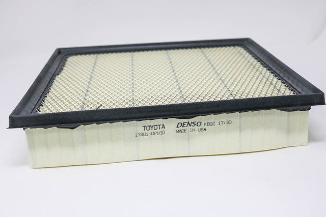

    Since I just posted this in another thread just a quick reminder to not let the Toyota counter guy sell you the YZZ economy line for a savings of $2 or $3 bucks. Only buy 17801-0P100 if going with OEM. f6f7056956308009aea406167f64bb27.jpg s-l1600.jpg
