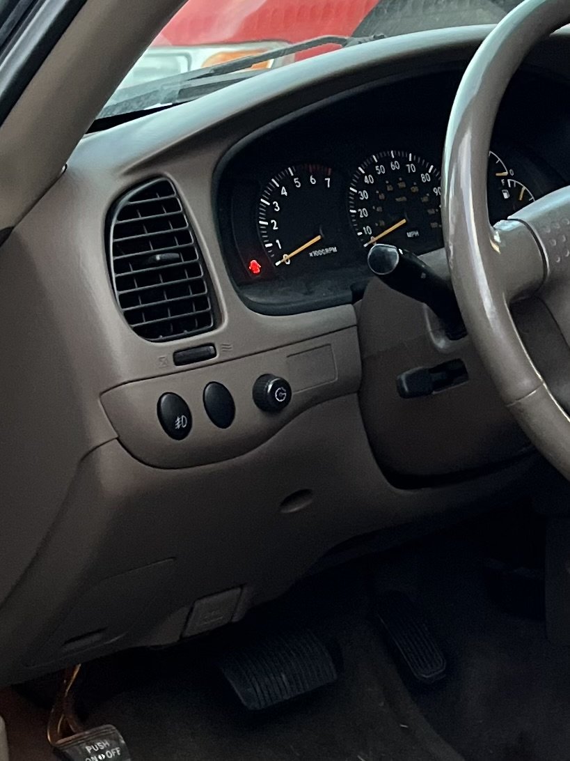

    2001 4x4 4.7L “Best Cab”/AC Limited 53k mi
    On my truck (a 2001) it’s the left-most black circular switch.

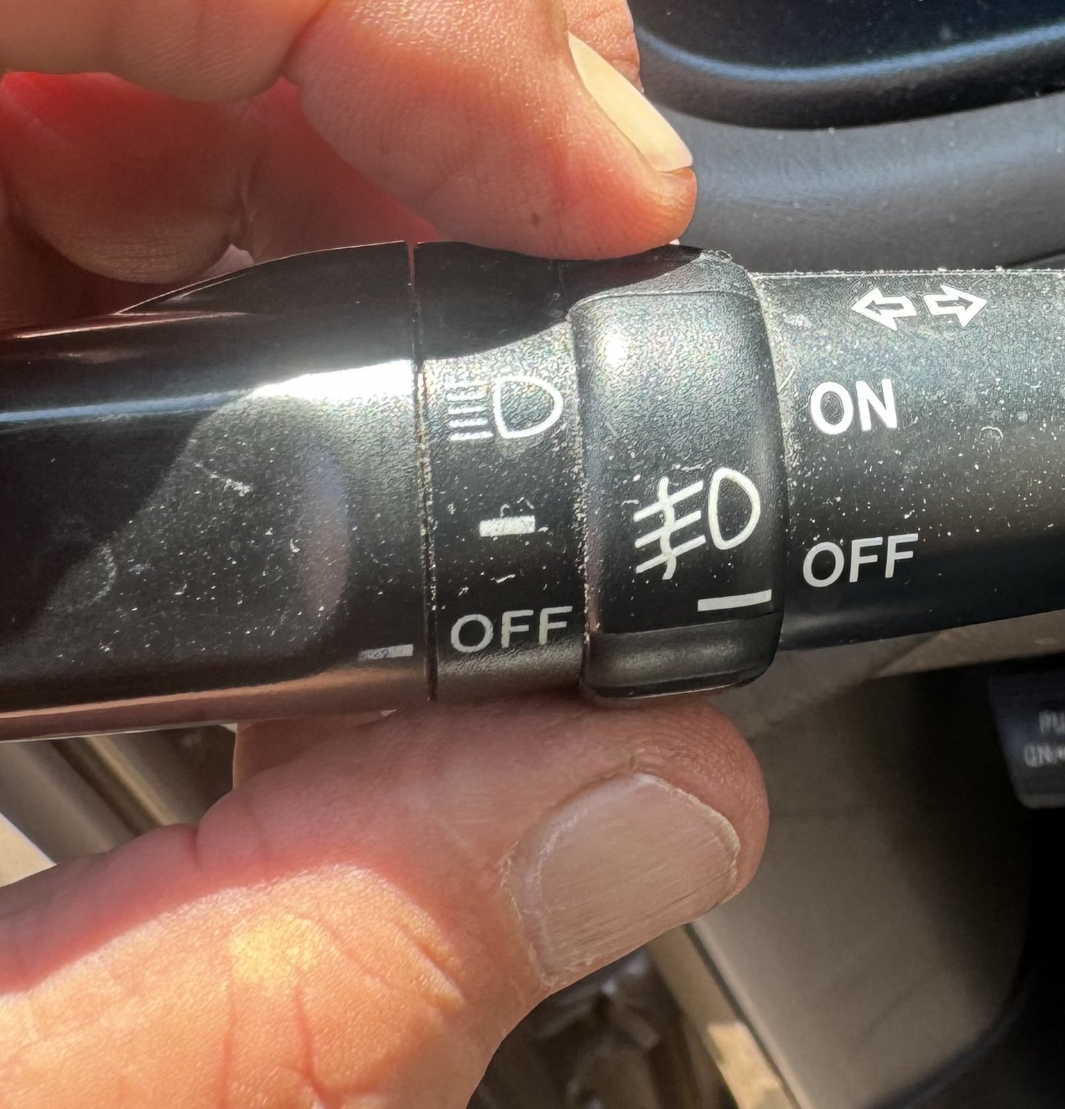

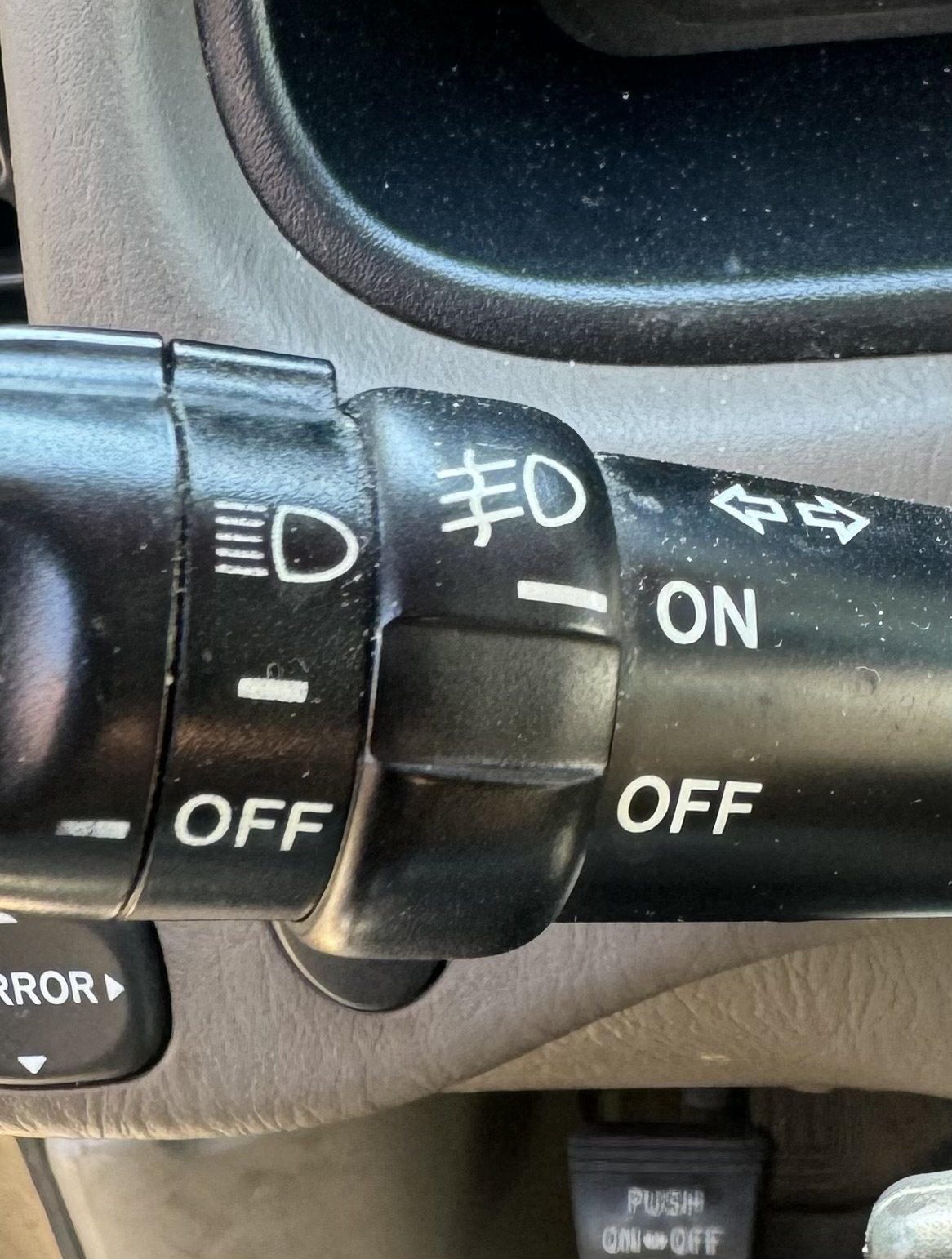

    Mine is 06 but sounds like it is the same or very similar
    I've got my fingers on it here in the off position
    here it is in the on position
