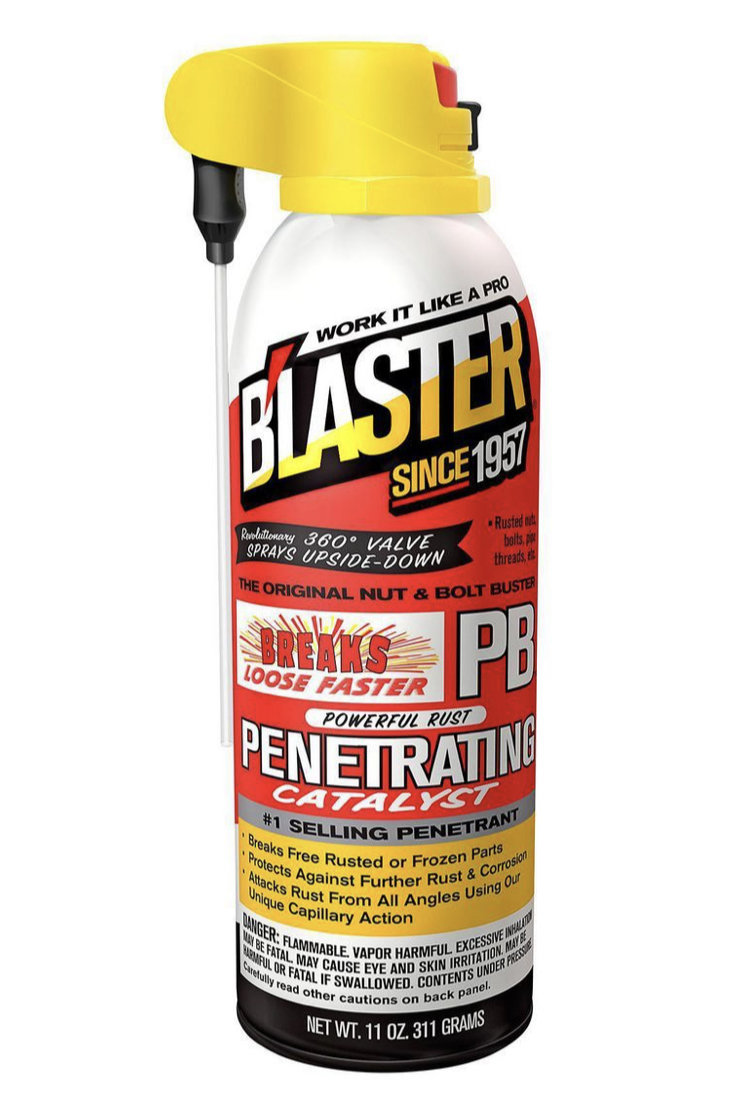

  10. May 3, 2024 at 9:23 PM
    Diablo169
    Diablo169 ROKRAPR
    Feb 24, 2021
    #59576
    665
    Max
    Santa Cruz
    06 Double Cab 360k+
    2” Lift, Bilstein 5100’s and 885’s second notch, Rear 5100’s Icon 3 Leaf Pack and Firestone Air Bags w/Daystar Cradles. Spider Trax 1.25” Wheel Spacers, 4Runner Pro Wheels, Falken AT3W 285/75r17 (34x11).
    Or use one of these. 100% of the time, it works everytime.
    B888s, Elevatorguy, shifty` and 2 others like this.

    I tried this without luck. Some DDA44C86-6E22-4677-80DD-AAF4D7713710.jpg and a tube extending the breaker bar did the trick.
