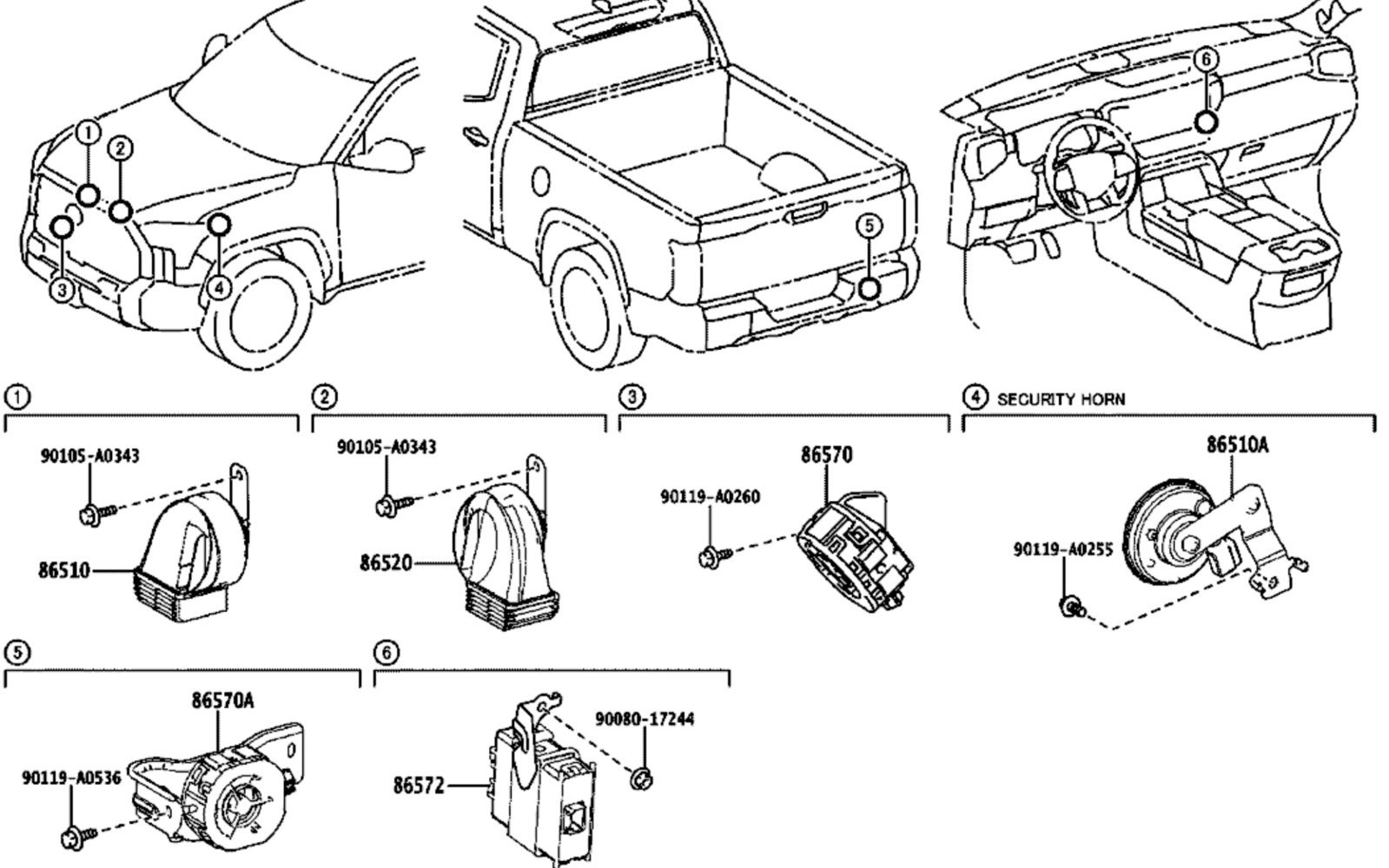

    I'm wondering if I can unplug the hybrid noise speaker that turns on once the truck switches to hybrid mode. I have a TRD PRO 24 but I'm not a fan of the hybrid speaker noise I know its some mandatory safety measure but it would be nice to hypothetically disable it in off-road scenarios.
    1. I think it sounds goofy
    2. I'm using the truck to get to tree stands and it would be nice if it could be silent.
    IE The Jetsons noise lol.

    I mean it should just be a speaker somewhere, so I’d imagine it could be unplugged. Maybe someone who’s located the speaker can post a picture of it so our truck tech nerds can chime in

    Toyota calls these - speaker, vehicle approaching. If your vehicles has them, they will be 3 and 5 in the diagram, 6 is the ECU.

    Gotta say it…. If you collide with a pedestrian, the liability could likely be substantial if it becomes known you disabled this feature.
    That said. Do the resistor mod, or even wrap/contain the speaker to reduce the sound.
