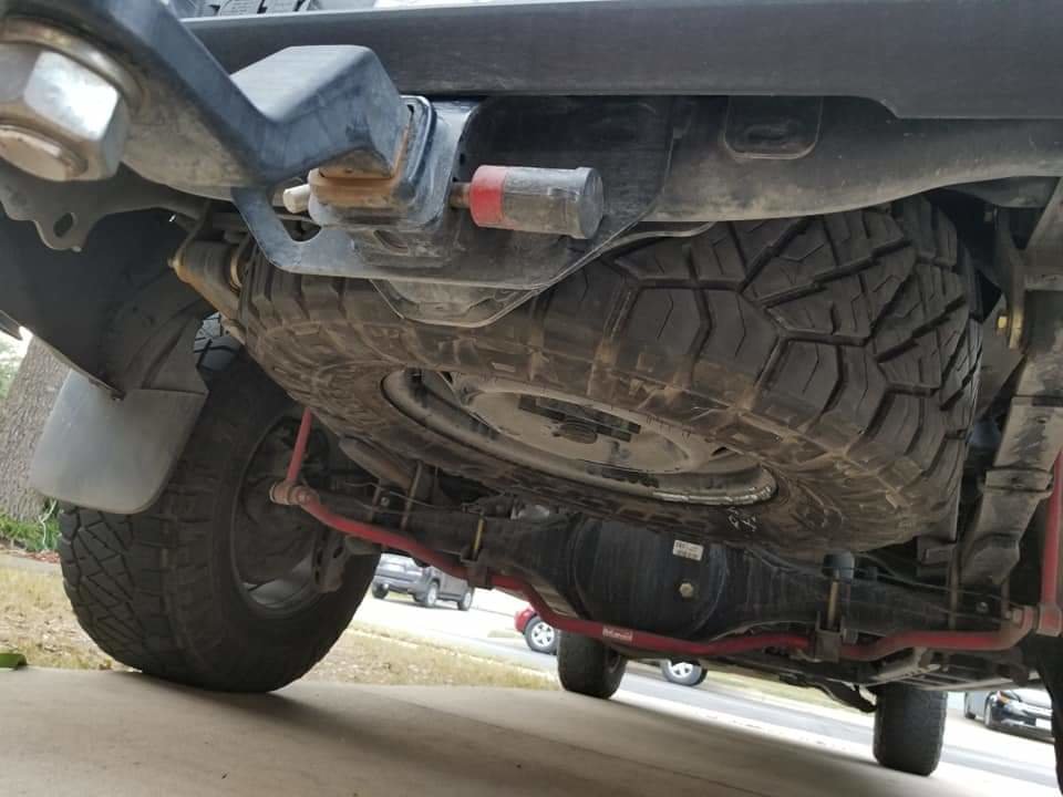

    Here is a 295/70/18 spare tire under the truck
    equin and MR TRD PRO like this.

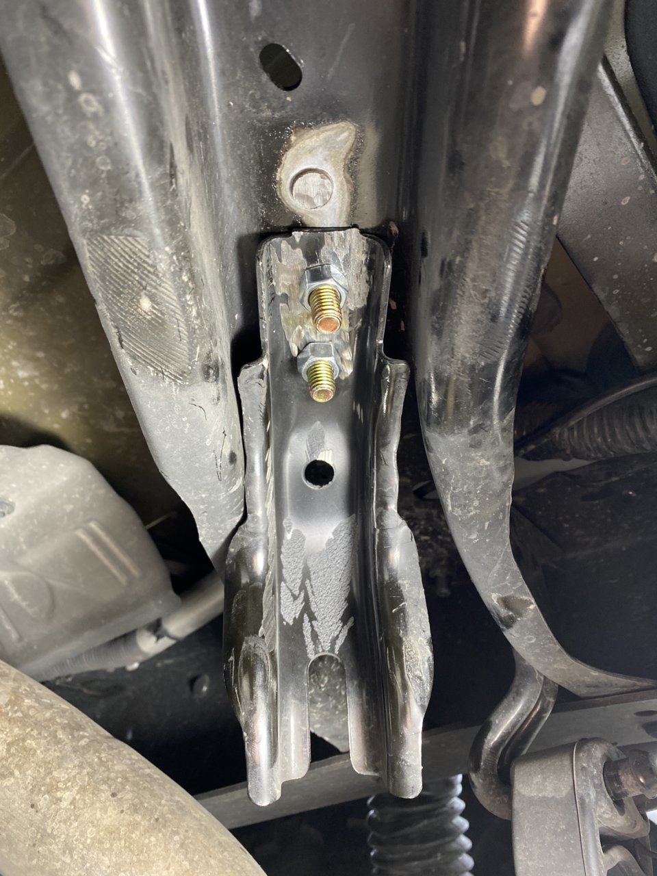

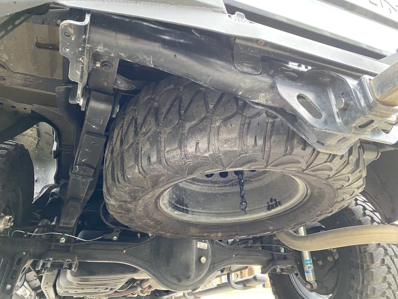

    Relocated the brackets and fit a 35
    F2553709-2B1B-4CCC-801B-8D336262EE53.jpg 2684F174-6DA1-442B-9665-33A6AFD2F742.jpg
    equin, EDDO, Skey44 and 3 others like this.
