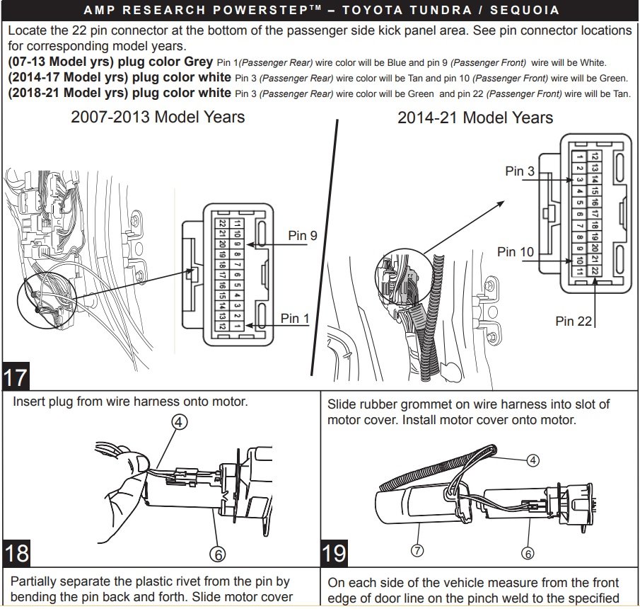

    I recently purchased and installed the Amp Research Powersteps for my 2016 Tundra Crewmax. The wiring is an absolute nightmare (for me). Does anyone on here who have installed these steps have color pictures of the wiring? I've scoured the interwebs and haven't had much help. Anything help will be greatly appreciated.

    According to the Installation Guide for your year, submodel, body style....the connector you're looking for is the 22 pin located passenger kick panel pin 3 tan/10 green, if that helps !
    AMPIS-75137.pdf (amp-research.com)

    This is the same diagram as was included in the kit, but a little clearer. I was hoping for actual color pictures of someone's install. Thank you.
