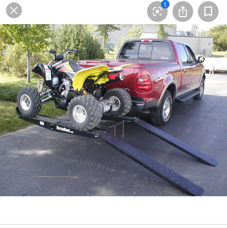

    Could our trucks handle this atv carrier? Atv weighs 400lbs wet.
  2. Nov 19, 2019 at 10:24 AM
    32,756
    Look at the weight rating tags in your door. 400 lb ATV should be fine. Hitch weight and payload are both over that.

    I know the tongue weight rating is higher than this setup, but i can understand if the forces are a little different in that there are no wheels on the other side of that trailer tongue?
    Carrier weighs up to 116lbs
  5. Nov 19, 2019 at 10:50 AM
    32,756
    True. The leverage would be something to account for, but that's above my pay grade. I don't see why you wouldn't just put the ATV in the bed. It's already eating a bunch of payload, so it's not like you can load the bed up with a bunch anyway. Just my thoughts.

    The leverage from that being feet away from your truck is enormous. Think of a bowling ball on the end of a broom handle, you’d never be able to pick that up. If I’m understanding, you’re looking at this in combo with a camper in the bed? No way you’re under payload with that atv in that spot. Get a trailer....
    Bama, landphil and Pinay like this.

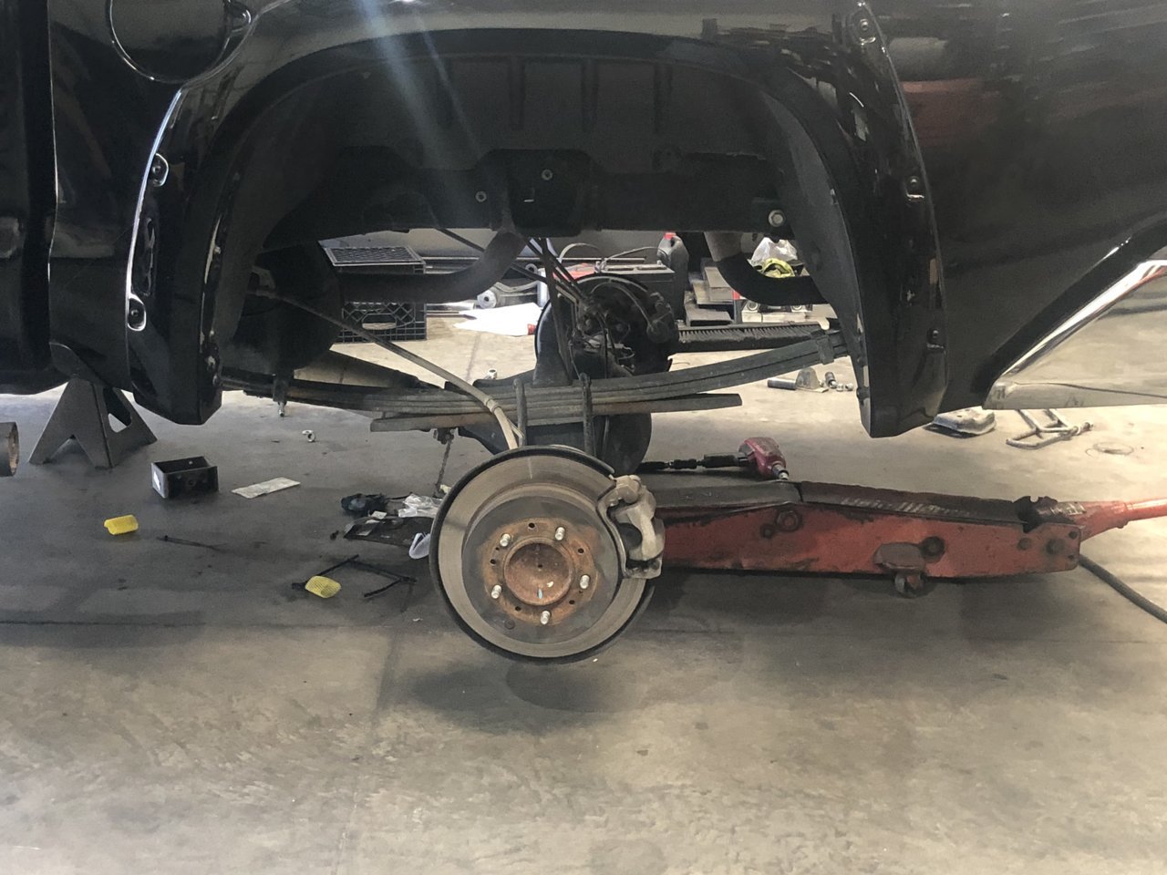

    Max tongue weight is like 900lbs. Should be fine. Take it slow over bumps. I’ve had a double dirt bike carrier on mine with about 500lbs and no issues. I was more afraid of the rack breaking. And careful on inclines and dips, the back of the rack will be really easy to drag.

    I wouldn’t use it in my tundra.
    The weight x the center of gravity distance to the hitch is the moment the hitch bracket to the frame has to resist.
    The 900# tongue weight limit x the distance from the hitch to the ball is WAY less than what you are looking at in the photo.
    that thing is going to bounce and put a lot of stress on things.

    If you drive over bumps with a trailer isn’t that the same force
  27. Nov 20, 2019 at 3:39 PM
    #27
    salmonator
    salmonator New Member
    Jan 8, 2019
    #24185
    104
    Tigard, OR
    2019 Tundra SR5 4x4 DC
    Same weight but different moment due to the way way way longer moment arm.
    think of turning a bolt - std wrench vs a breaker bar or cheater pipe over the wrench. Force multiplier.

    There are some engineering variables since the draw bar is 3 feet long vs 9 inches or what ever a standard draw bar is. 300 pounds input on a 9" ratchet is less torque than a 3 foot one. But the quad carrier force is spread over the 3 feet, not at the end of it like a hitch, so there's some math to figure what it really is. In my opinion and experience it's fine. Others may not be comfortable. Do what makes you comfortable.

    Oooooh ok get it now. It’s as if you had the trailer attached to a 3 foot long hitch insert

    And to think, at its furthest point its like 5ft away from the truck (my best guess). Imagine what you could turn with a 5’ breaker bar to put it in perspective. My money would be on the atv hitch arm snapping before the tundras hitch fails. That bouncing takes a toll.
