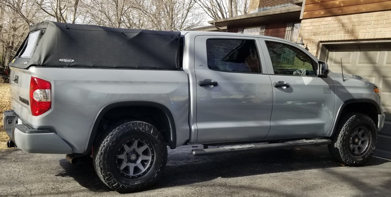

    If it fits your eye, consider a 17in rim. You can get a 'beefier' tire that carries the same overall height on a smaller wheel.
    https://www.tundras.com/threads/anyone-running-17-rims-on-your-2-5-gen.23617/
    This is a 17 rim with about 2 inches loft in the front on 305 70 17
