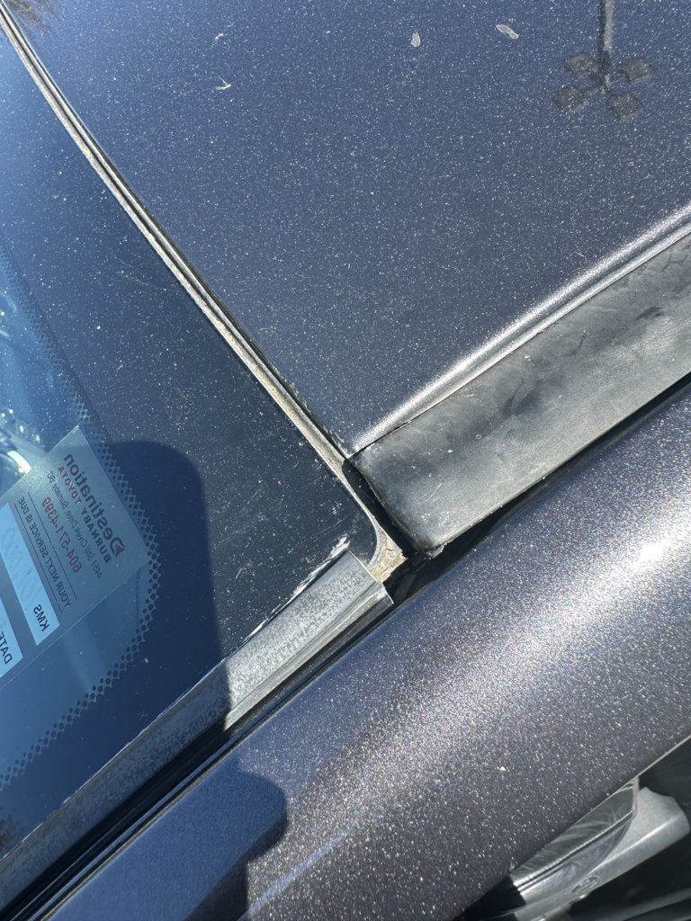

    Hi,
    So, had some work done that also meant replacing my windshield and now I have a really annoying wind whistle. I’m trying to figure out if it’s the trim, before I take it back to the shop.
    Can someone check their truck (mine’s a 2016) and see if the edge trim goes to the top of the windshield? See the attached pic.
    thanks!

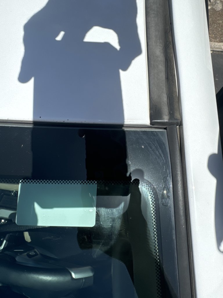

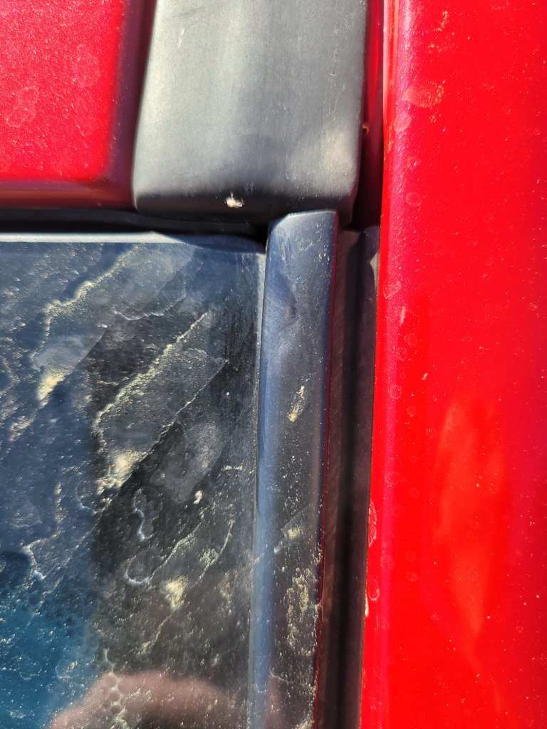

  2. Apr 17, 2025 at 12:56 PM
    1UP
    1UP Truck Gang
    Oct 21, 2020
    #53887
    2,600
    2019 Red CM TRD sport 4x4
    Mine sits flush both sides

  4. Apr 17, 2025 at 1:33 PM
    AZTundra
    Feb 13, 2018
    #12894
    4,493
    Paul
    Phoenix, AZ
    Same here. 2017 with original windshield.
  5. Apr 17, 2025 at 1:37 PM
    MadMaxCanon
    MadMaxCanon New Member
    May 27, 2021
    #63566
    4,601
    SoCal
    '21 CM SR5 4x4 6 seater
    Too many, but not enough....
    No Pic but mine goes all the way up
  6. Apr 17, 2025 at 1:41 PM
    JMGmanAZ
    JMGmanAZ New Member
    Oct 12, 2023
    #105281
    1,339
    Jerry
    Belly of the Beast
    2014 1794
    2017 with OE glass in AZ... :eek:

  9. Apr 17, 2025 at 7:40 PM
    d33pt
    d33pt New Member
    Jan 3, 2024
    #109575
    208
    Try putting a piece of tape over that section and see if the whistle goes away.

    So, after poking around, I found out two things:
    1) the trim was like that before, and I never noticed (shop does extensive before/after pics). Still weird.
    2) wind noise was coming from the drivers side mirror. Seems the seal decided to pick that time to finally die. (Guessing maybe it got jostled during the work? Who knows)
    The happy end result - shop took the truck while I was there, figured out where the noise was coming from, disassembled mirror and resealed it, and reinstalled it - all for no charge.
    Thanks for everyone’s help! Now I’ll just have to figure out the trim issue because now that I know it’s there, it bugs me. :(
